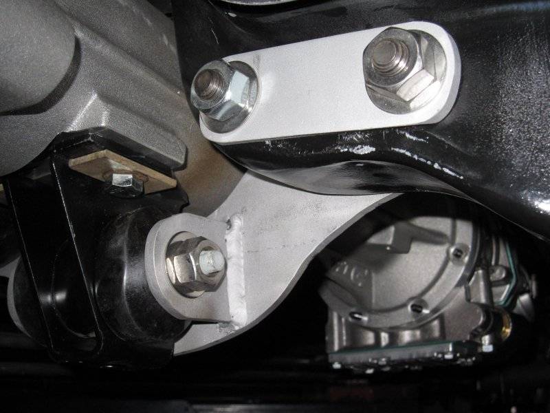

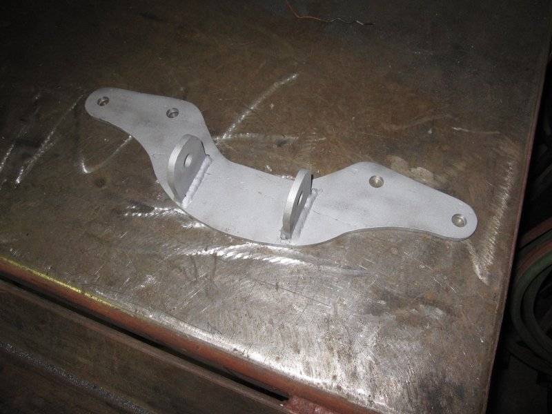

I had a steel spacer used in mounting a fifth wheel hitch. A took my time rounding it to fit on the block.(driver side) 360.
Edit, one of these I think.
