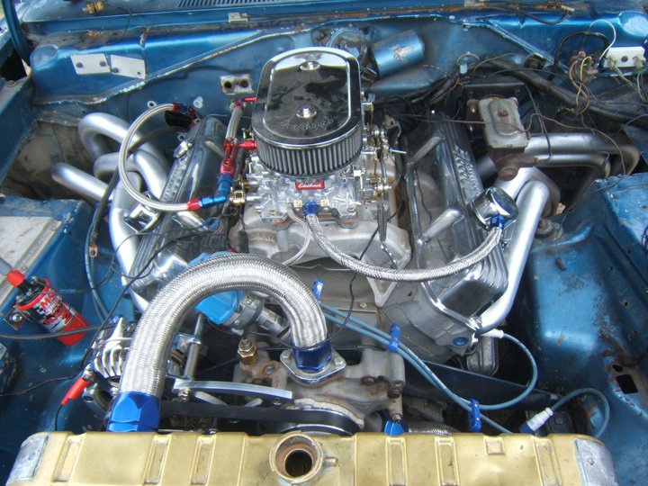

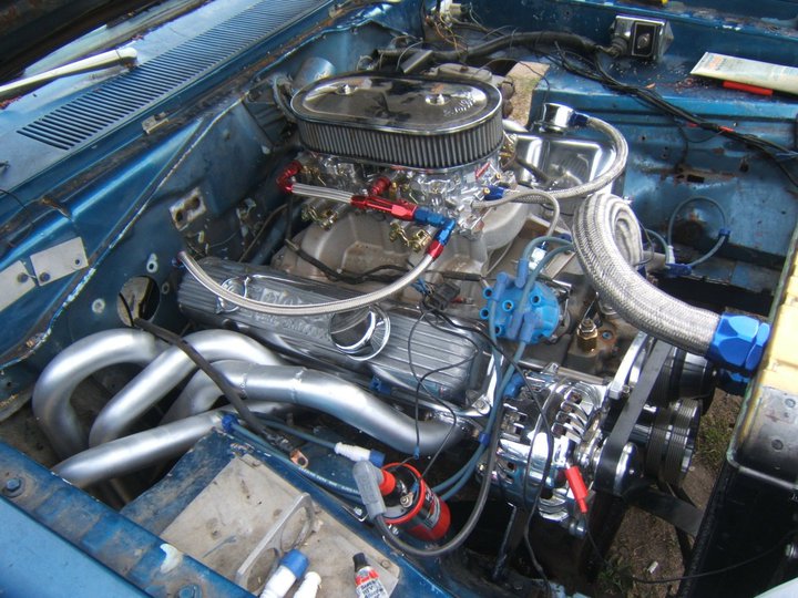

well here's a plate I put into a '73 440 scamp. As you can see, the alternator cleared the plate no problem, but I see your plate does have quite a bit more meat on it. The bottom alternator bolt goes into the plate itself.

Did you make those A-body fenderwell headers yourself? You're a brave man. That is also the same induction set-up exactly that we'll be starting with. I have two 2" Offy spacers that I will be experimenting with as well. Failing that I'll bring my M1/950 double pumper to the track in the back seat in case the dual quad sucks.
To the original response though, your motor plate is substantially more svelte than the one I've got. I think they wanted to just cover every application and trim as needed. A notch in the bottom of the plate would work and use the alternator pivot point on the plate itself.
I wish I could make headers like these! These are old hooker fenderwell's I had to repair and re-coat. The carb spacers are probably a good idea - little more plenum space. With your motor plate, i'd do the same thing you're gonna do - trim to fit.

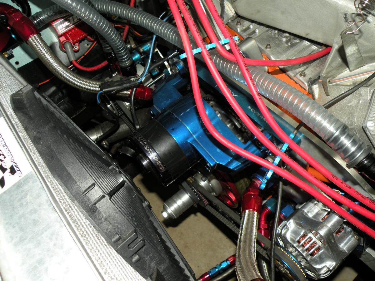

Here's mine. top motor plate bracket. works great.
