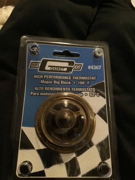

Freshand up my 383 and had it started and run on a dyno.The tech told me the thermostat hung up but righted it’s self and seamed fine. On the third pull it hung again. MY BAD installed in car ran to check for any problems all good. Today going to dial on the new Holley,stepped out of the shop with the motor running to let it warm up!!!!!! Did it heat uppppp,stat stuck AGAIN came it overflow was pucking coolant.Lesson learned THINGS DO NOT FIX THEM SELVES

Personally, I stay clear of anything Mr. Gasket!

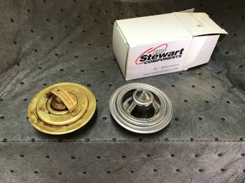

That NAPA one may have an opening too small for good flow, most are around 1". '67 mopar thermostats have an 1.5" opening, the EMP/Robertshaw ones sold by Summit have a similar sized opening. Lots of problems w Mr Gasket 'stats from what I've seen.
good quality and flow.
Bought several (high flow) t-stats. Had overheating issues on and off. Got disgusted and put 4 of the bastards in hot water slowly heating to boiling and 3 out of 4 were ****. One didn't open at all, a 160 stat didn't open at all until 200 degrees. Another never opened wider than 1/2 way. I know that one of them was definitely a Mr. Gasket. Don't remember which one I finally installed but I know I bought most from Summit, but I don't blame them. I drilled that 1/8" hole through it also. Has worked okay ever since.
We just beat this to death in the A body forum where the majority of guys had problems with the Mr. Gasket thermostats. I just had 2 new ones crap out. I now have edelbrock and works well so far. Put it in yesterday.
Thanks for the heads up. I just got one of these for the 383 build. Will definitely be testing it on the stove before putting it in.
