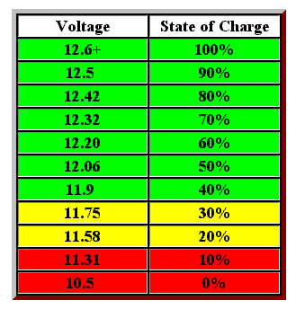

What is the battery voltage when it's cranking? I don't think the starter is your issue here. Do you have spark at the plugs when it's turning over?

Cranking voltage is about 11 volts, checked for voltage to module during cranking, battery voltage. Checked for voltage to positive coil during cranking, ok, no pulse on negative side.
When I pull distributor and spin it, it won't spark when I turn at slower speed, which makes me think it may need cranking issue.
Good question on the coil. I have cooked Napa brad coils with a MSD 6AL.
It sounds like you have enough cranking voltage that it should have spark.
