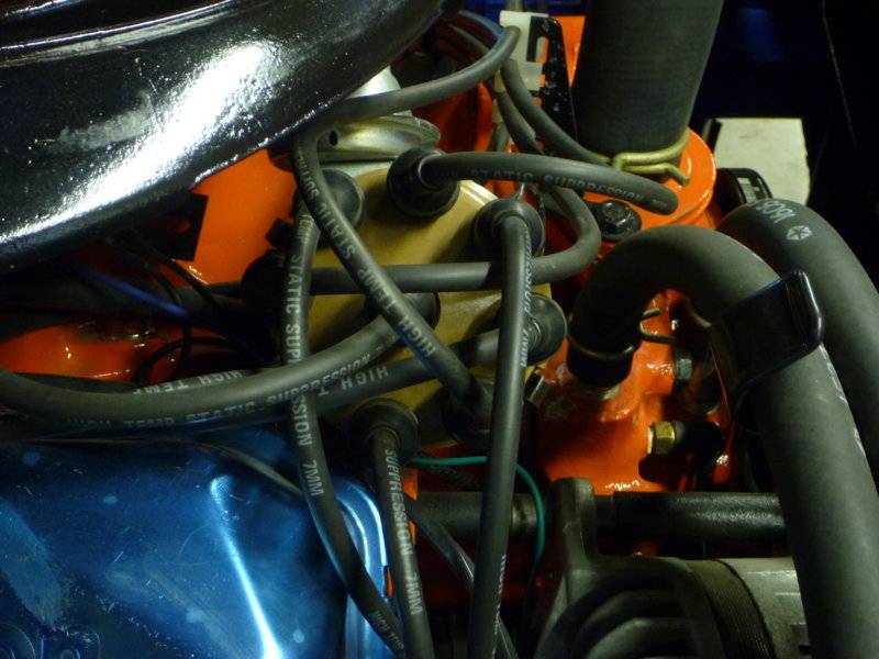

I'll go look.. I don't think the cleaner comes out that far..
Height probably not an issue.. the diameter would be the question as I picked up an MSD at an auction and they're huge.

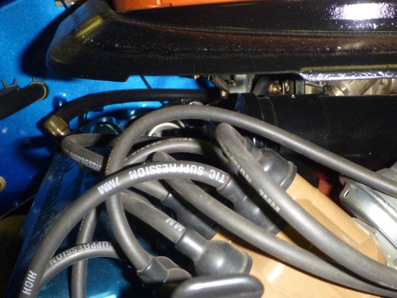

If I get what you’re asking correctly - I have that MSD distributor in my GTX. I also have a six pack set up on it thus the correct air cleaner for same. That would be the oval set up. I don’t have any clearance problems. Everything works well and clears well.

Straight on shot and underneath..
