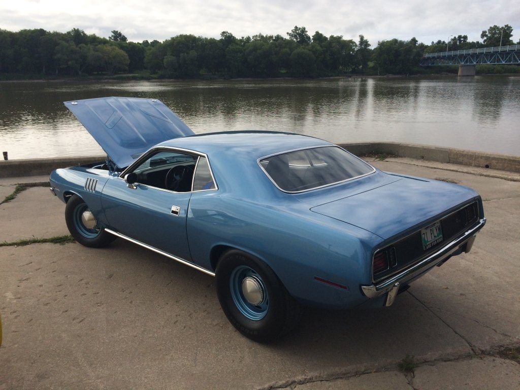

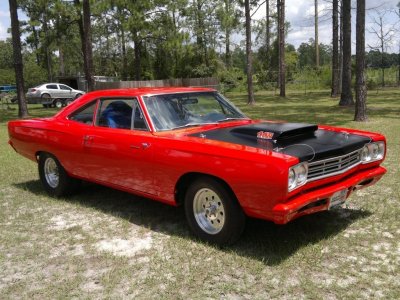

I have 295-65s on 8" rims on my Cuda. The 8" rim is the narrowest recommended rim.

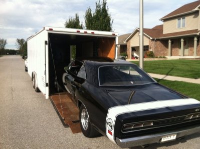

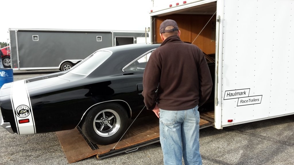

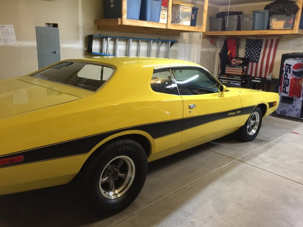

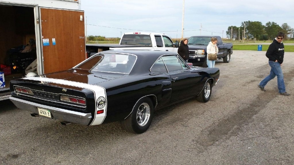

I had 295 65 15 mt dr on my 73 charger on 8 inch wheel with 4inch backspace they worked but they would be better on 10inch wheel

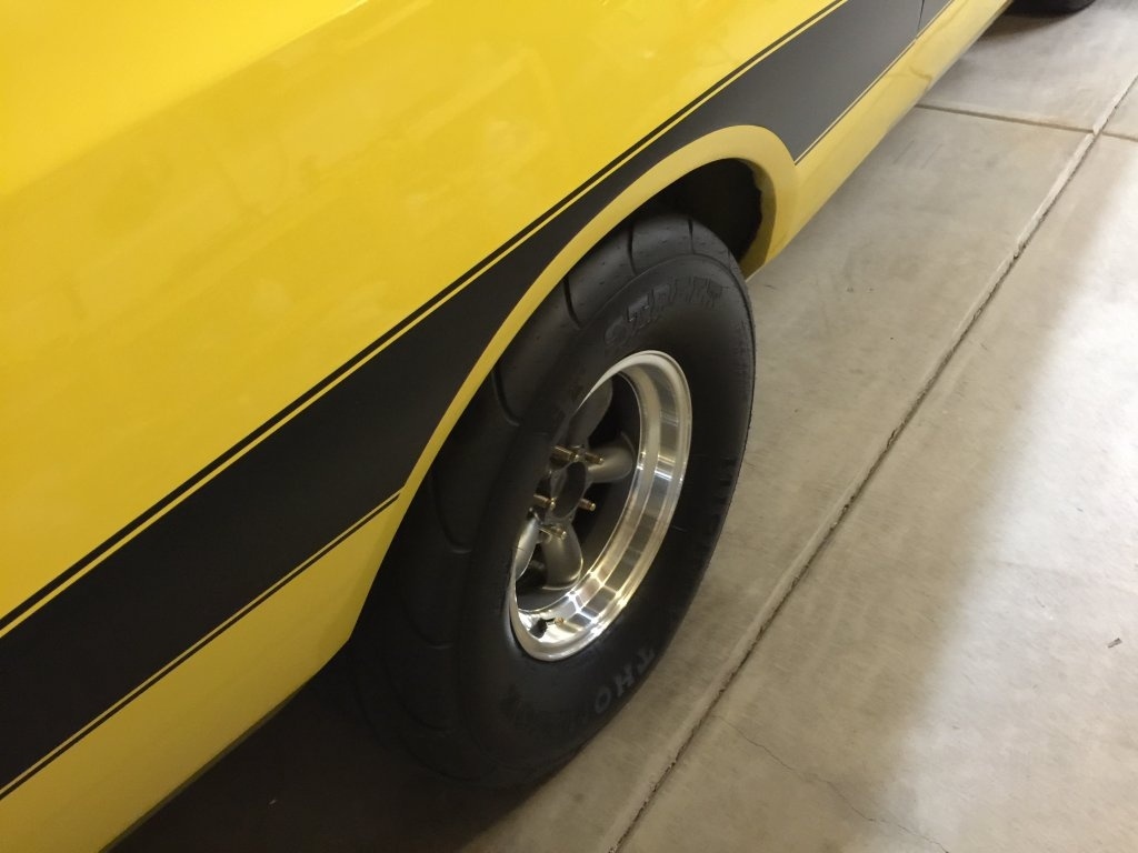

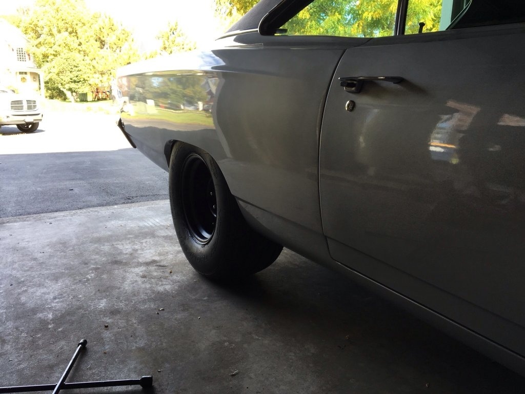

Here's my 295 on a 10" wheel. No bulging.

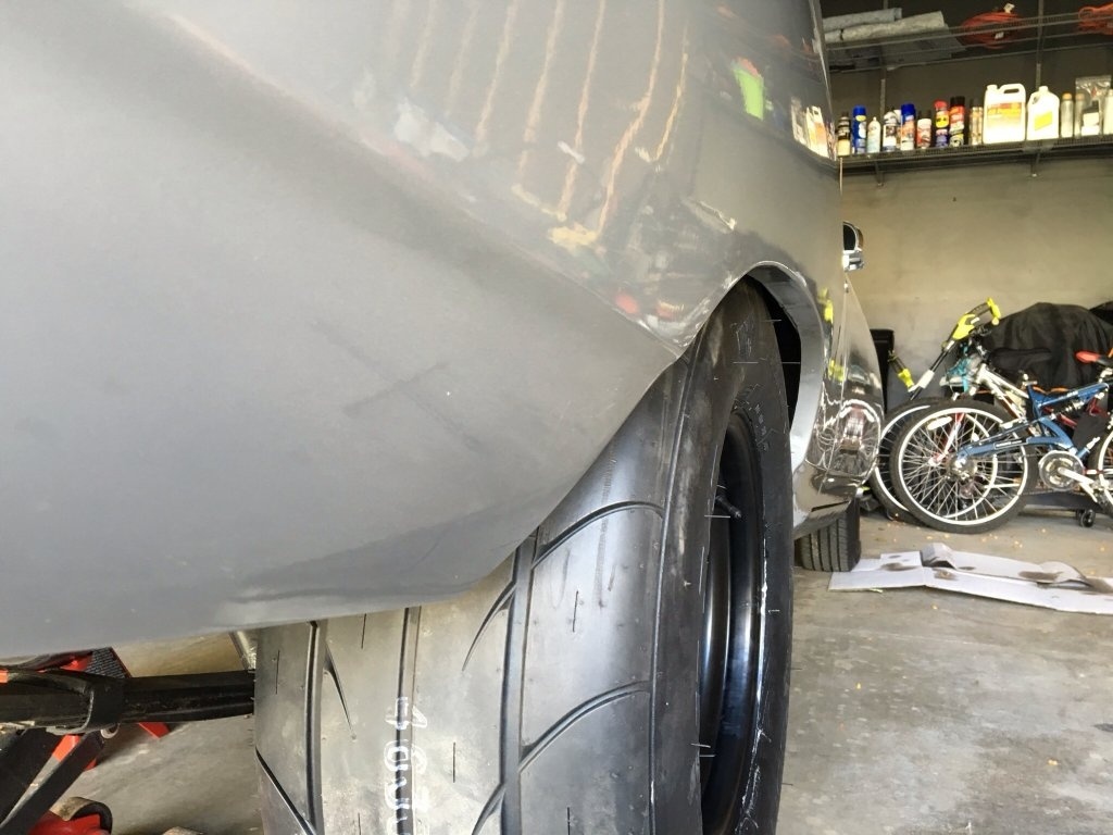

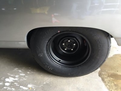

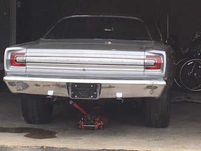

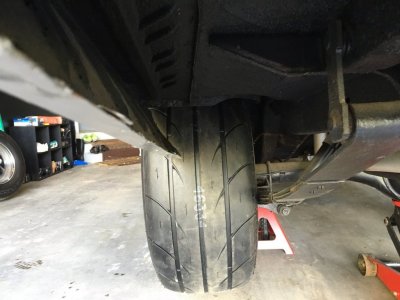

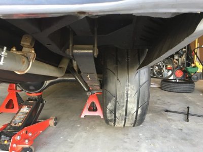

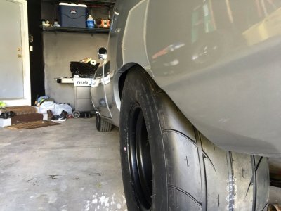

Funny this was what I did today...15x10 with5.5 back space, 295/65r15s. This is with stock 318 Satellite springs and ride height. Inner lip is TIGHT! Will roll or shave the lip and already planned on th +1 inch lift split mono springs.

How much space do you have on the inside?
The wheel spun free. Didn't see any issues rubbing on the springs. I have the 14 inch magnums back on now...waiting for some rear suspension parts, so I can't measure. Due to spot welds in the fender lip when they put on quarter skins I wasn't able to roll the lips and had to take them off so they wouldn't rub. I'm off next week. I'll try to measure then.
There's about a 1/4 to 1/2 inch from the leaf springs, and about the same on fender size. This is using the 5.5" backspaced 10" wheel.
