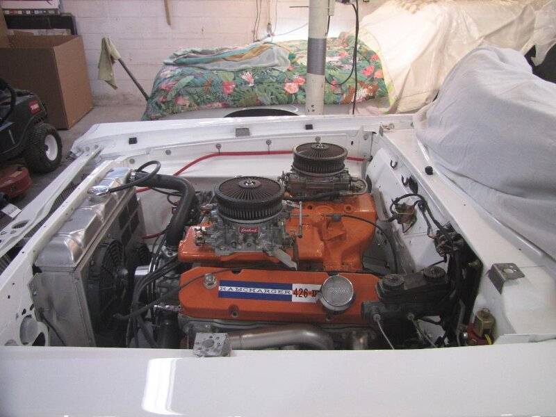

My 64 dodge has a VERY mushy brake pedal. I have manual brakes, wilwood disc brakes all around. No squeaks or squeals out of the brakes, car runs straight under braking, stopping power is marginal, at best. I have bled the brakes, fluid is fresh and clean, no air pockets. No leaks. Attached is a pic of the master cylinder. What should I check?

If the MC might not have been bled sure think it should have been or done properly (it can also be done on the care with care) bleeding the brakes all day won't remove air from it. Can't tell; someone knowing more could say, but that MC doesn't look right for the 4w disks...looks smaller than it should be if you have multi-piston calipers. Don't want to open a can of worms...just tossing out possible checks.

The master on your car in the photo is the aluminum/plastic Mopar used in the 80's.
Most of those cars were disc/drum.The residual pressure valve for the rear drums may have been removed for rear discs.
That may be the cause (maybe) for the spongy/mushy pedal.
In the photo the line lock valve looks higher than the base of the master.This may be the cause,trapped air in the line.
