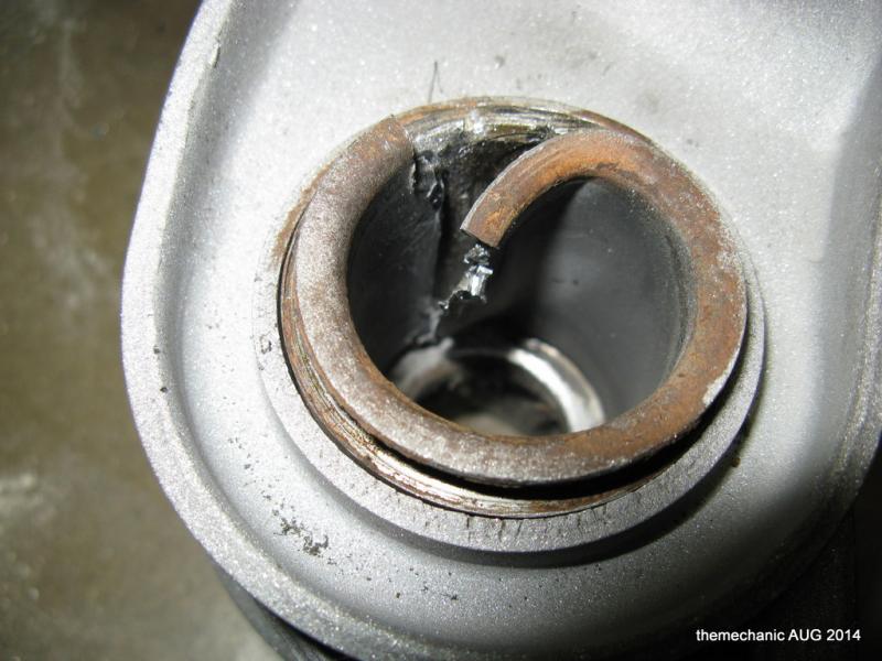

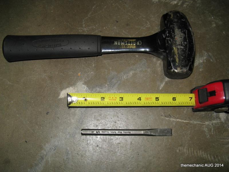

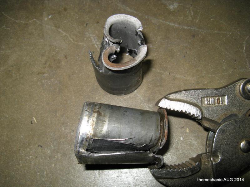

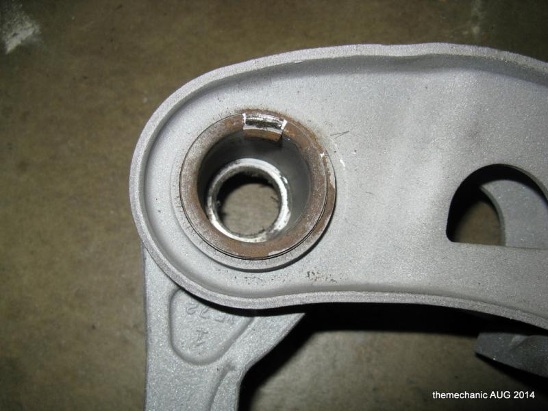

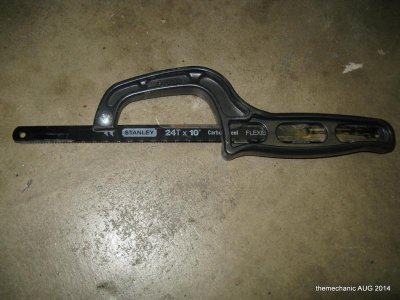

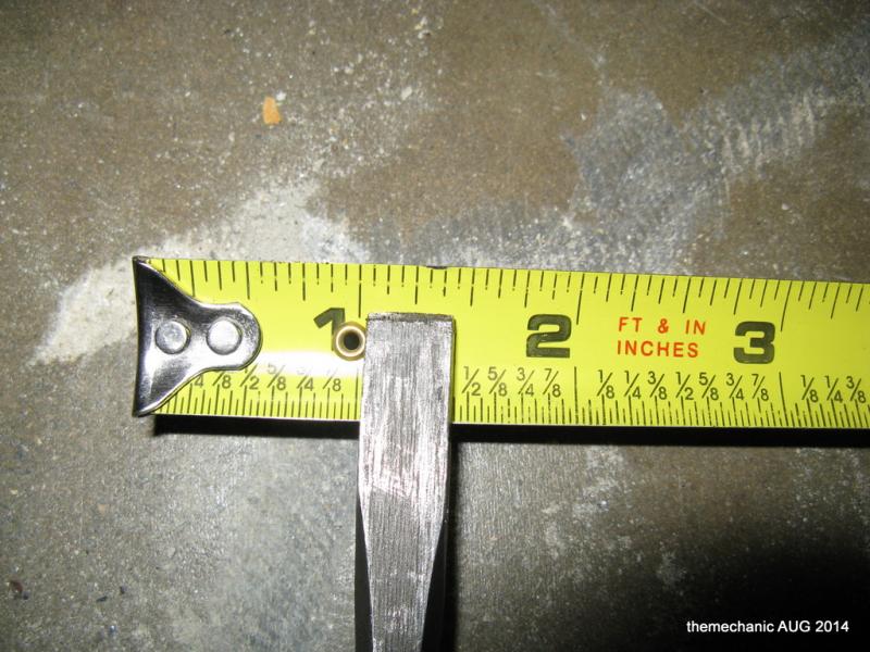

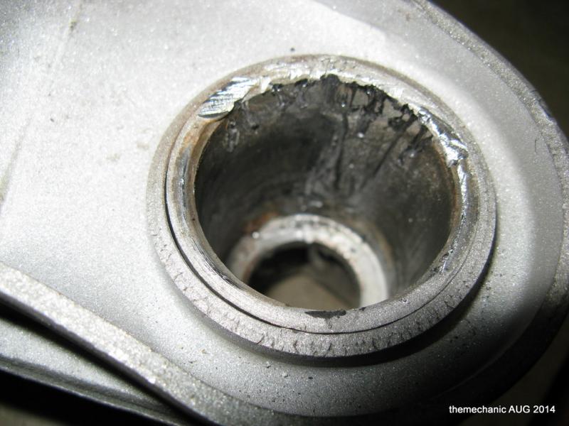

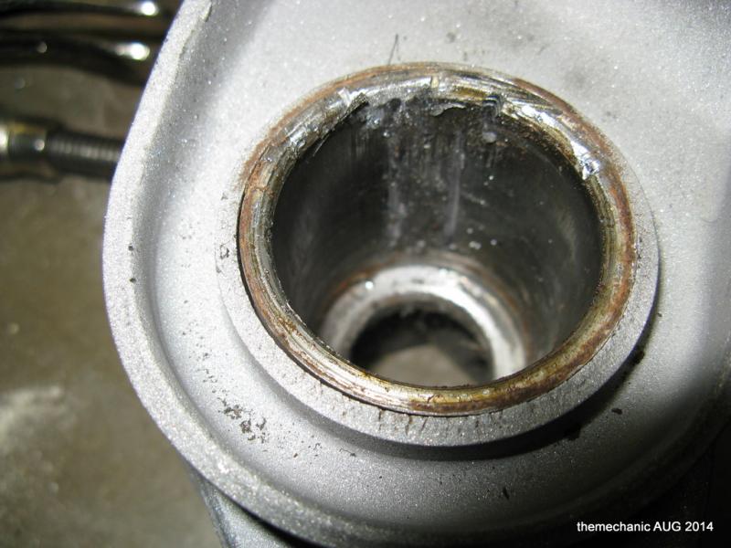

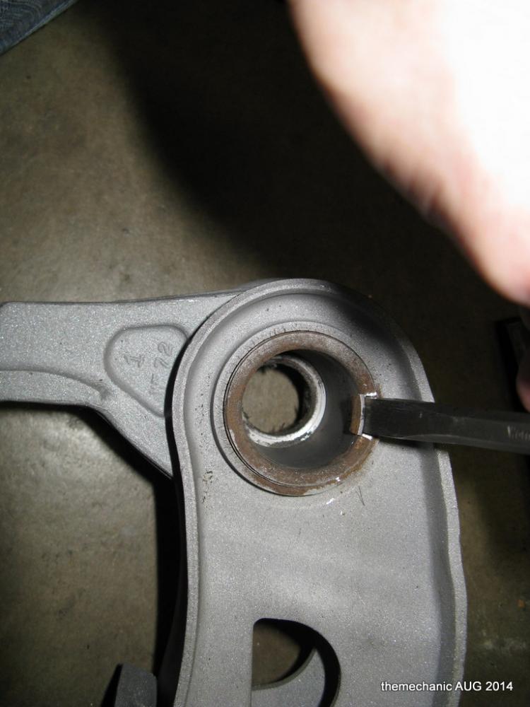

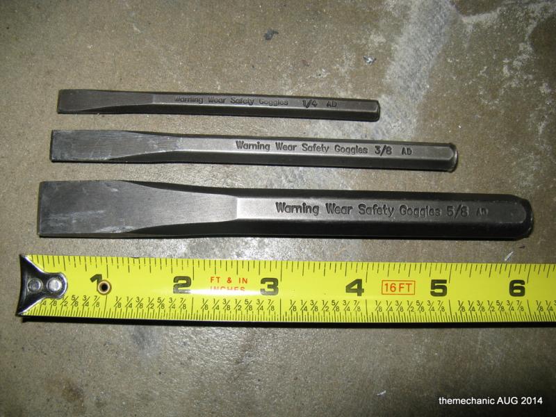

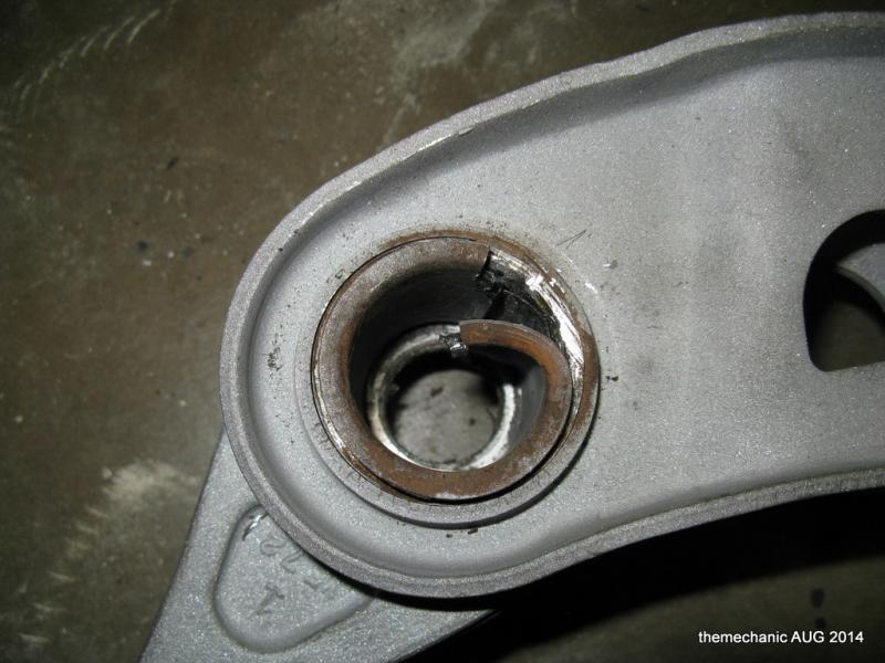

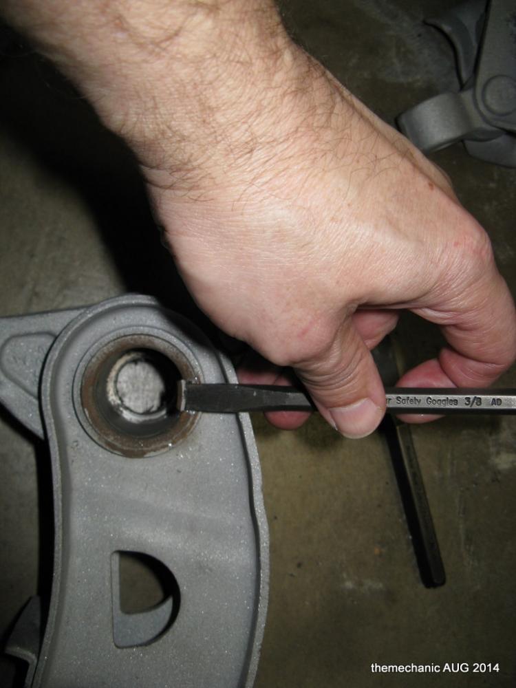

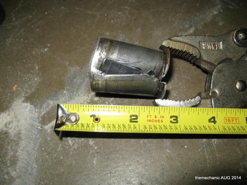

Here are the photos I took today of how I removed the lower control arm bushing with a hack saw, a hammer and chisel.
It comes out easy enough if you can manage to get the chisel started between the sleeve and the control arm hole. Use the hack saw to cut the sleeve flange then chisel that up so you can get the chisel started between the sleeve and control arm hole. Once you do just drive the chisel all the way down the sleeve to the bottom. Then chisel the opposite side of the cut inward to loosen the sleeve and pull it out with vise grips or pliers.
It scars the edge of the hole, which will need to be sanded smooth, but it will be hidden by the new bushing.
The first one I tried cutting the sleeve on opposite sides but that didn't work as well as just cutting one side.
Next time I'll take it to have a washer welded on and pres the sleeves out.
