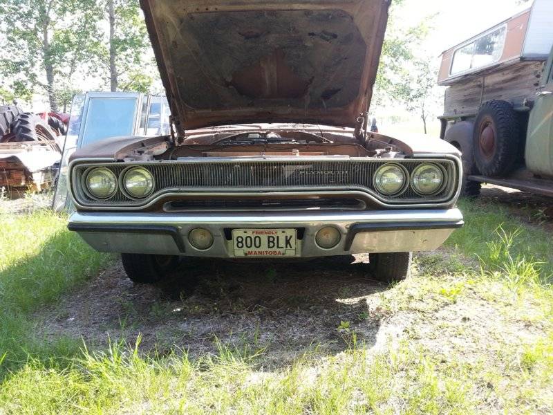

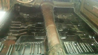

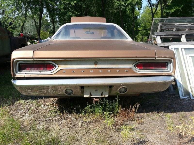

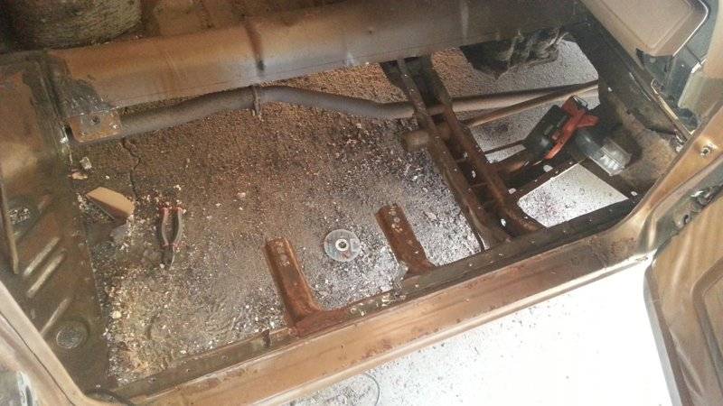

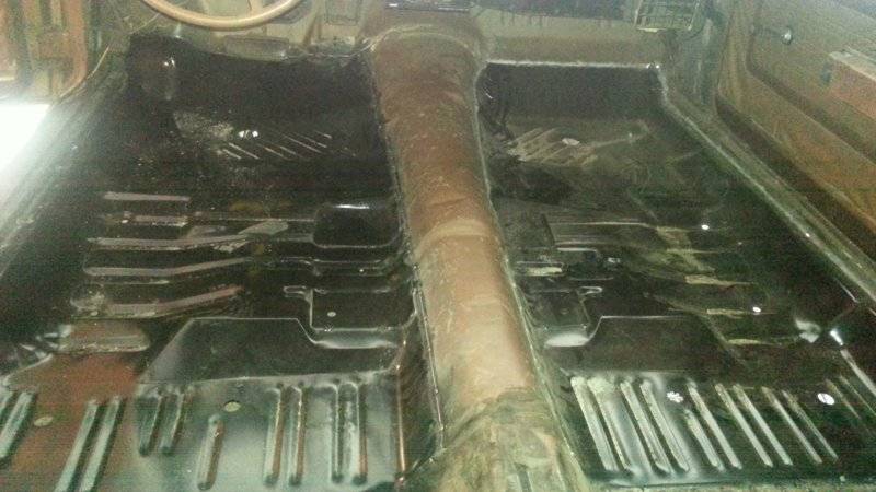

Hello all. I recently joined and put a few pics in the welcome section. I thought I would share a few more of the progress over the years. First few are before I bought the car. I had no idea what I was getting in to. A total resto rookie. My first project was the front floor halves.

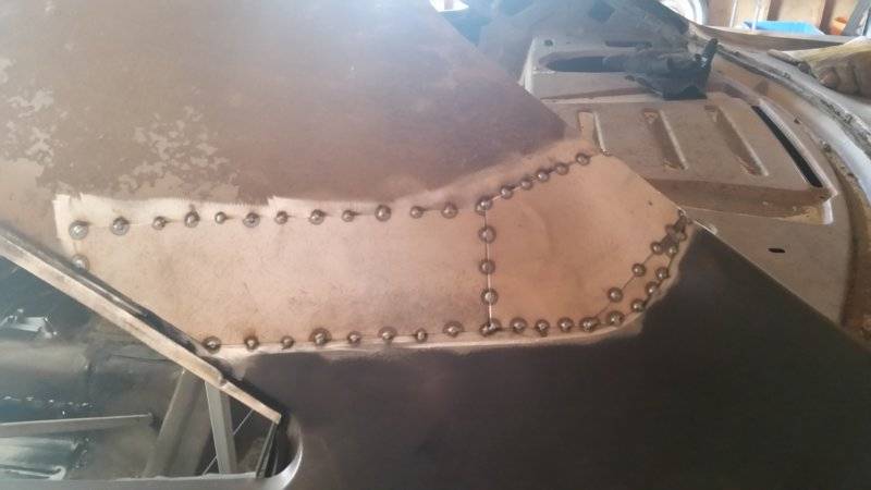

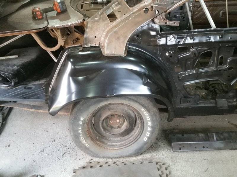

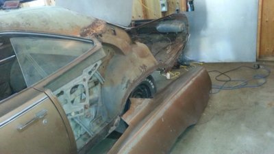

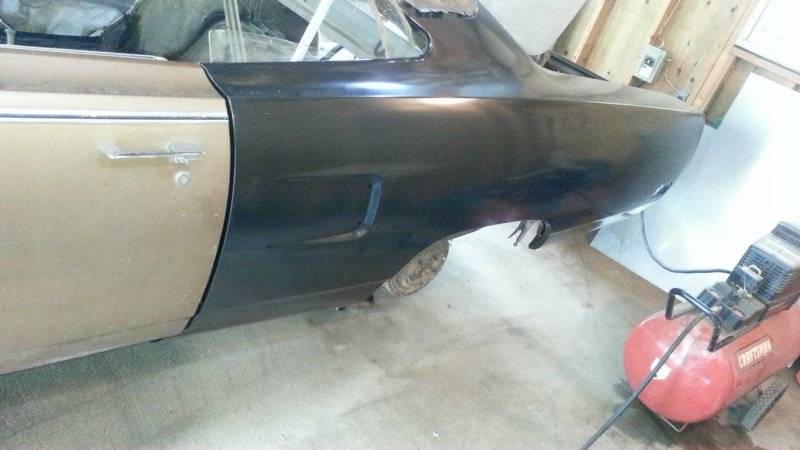

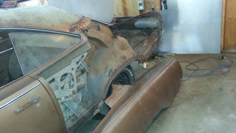

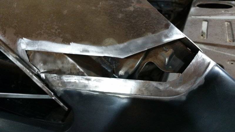

Here we have the quarters. As you can see there was a lot of rotten metal just above the quarter on the sail panel. It was from the vinyl roof trapping moisture. The next few pics show the fix of that issue.

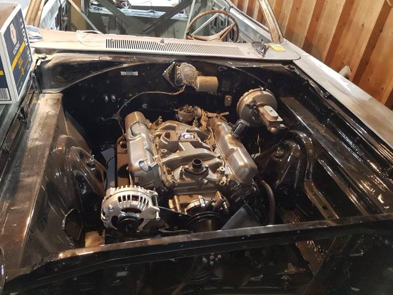

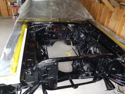

So I patched in some clean sheet metal which was welded solid of course before being covered in short strand fiber glass. It all blended in really nicely. I know it isn't a Mopar thing, but I wanted the engine bay gloss black,and after lots of sanding it was shot with 2 component.
20160730_115615.jpg 20160717_131843.jpg 20180609_125748.jpg 20180608_154125.jpg

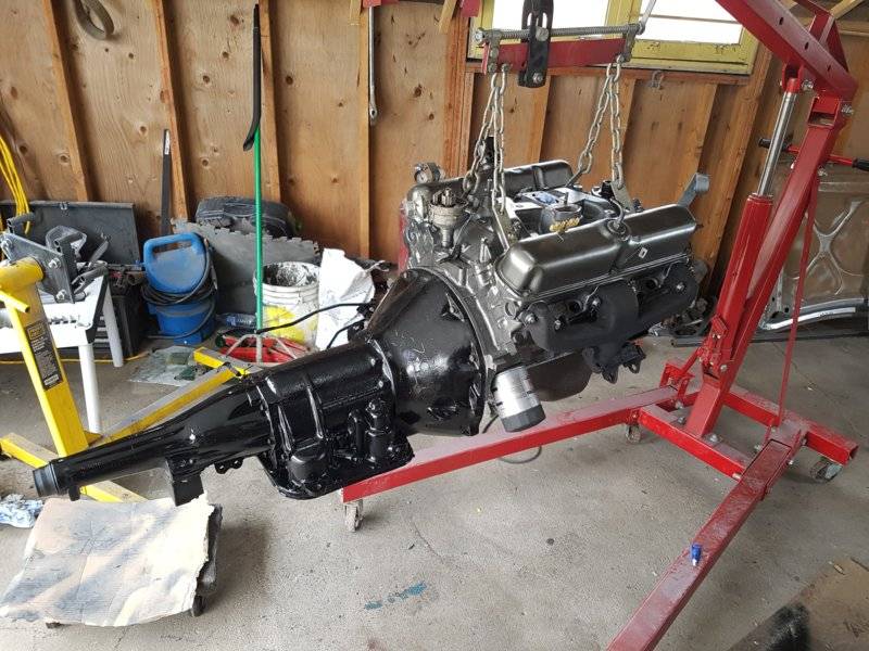

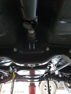

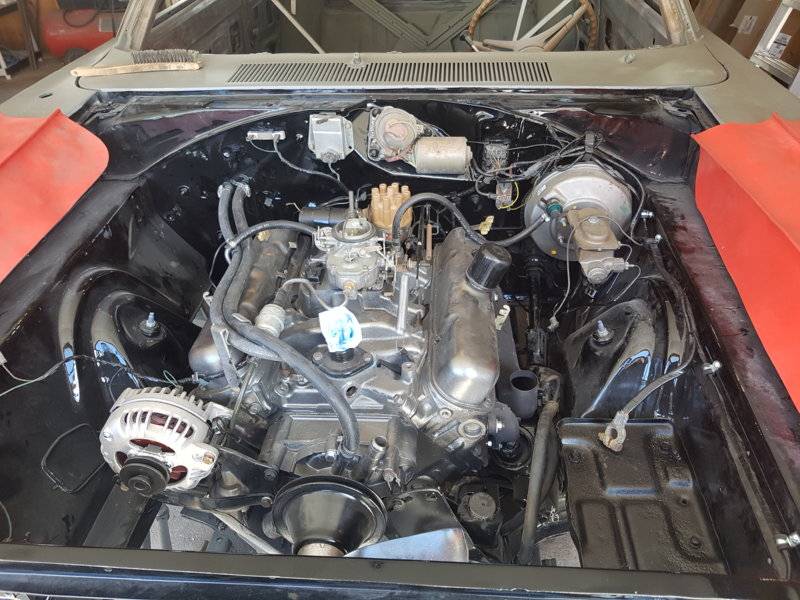

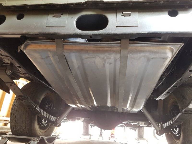

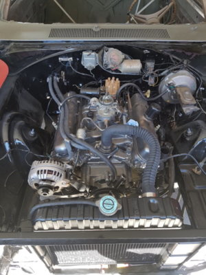

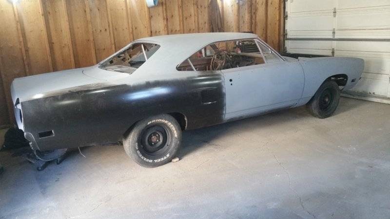

So the engine made it home. A 1969 318. The 1970 motor was too far gone. A nice clean underbody, the new fuel tank finally went in today, and the car in etch primer, except the quarters. Gotta sand the edp coating first.

Welcome Mark, nice job you're doing on that Satty. Is the 318 a stock build?
Looks to me like you are gonna have no trouble at all. Nice car
Yes, the 318 is stock. I put a new timing chain kit in(the camshaft timing gear was cracked as well) and new gaskets all around. I put my 1970 water pump on as it allowed my pulley driven accessories to line up. The main goal this year before stopping for winter is have the car in paint, have the car running, and have the headliner done and maybe carpet. Next year more than likely will be to finish interior, exterior trim, front windshield, bumpers, and a safety. Enjoying driving the car for July 1st next year. Here's hoping.

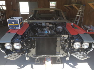

A little more progress the last week or so. Thought I'd share. The rad was finished today. Now a 3 core with original tanks. The car finally has eyes. The wiring is good enough to get the car running soon. Just doesn't look great. Really want this car running in the next 2 weeks. The new fuel tank had dual vents. So I hooked up the original and drilled and piped the second. A work in progress. My local part store has made me an unofficial staff member, lol.

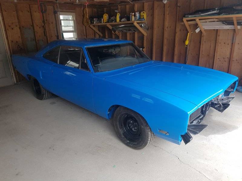

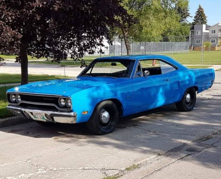

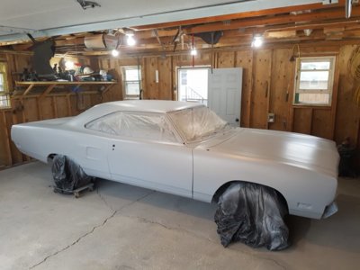

I was going through old posts, and had forgotten about this thread on the restoration. I Thought I'd pick up where I left off just to get caught up. So you can see it in the green self etching primer. It was still on jacks so I assume I was still working under the car. Brakes, diff, suspension, undercoating, etc. The grey was the first coating of high build primer. The first of 2 coats. Lots of block sanding. About 40 hours I think. Then the day it was home in its current blue. There was 3 different brands of paint tested, but all the same paint code. All different shades of blue. I test shot them all. This one is the one I chose. In the shade its much darker than I thought. I'm happy with it though.
Can't seem to upload the interior pics at this time. But the "finished" project was finally assembled, safetied, and driving around as of September 2nd, 2019. So as always, things took longer than expected. I have since decided on a 440 for it. It's at the machine shop now, and should be done by May. Hoping to have it in the car and driving by July. Old cars are like old houses. Are they ever really done?
