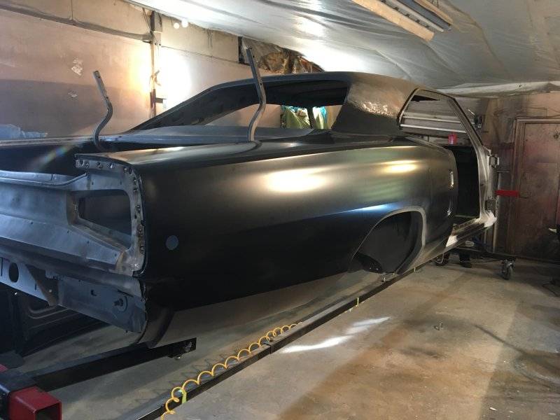

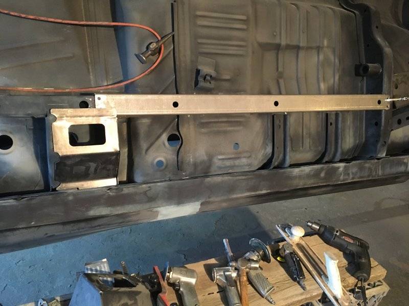

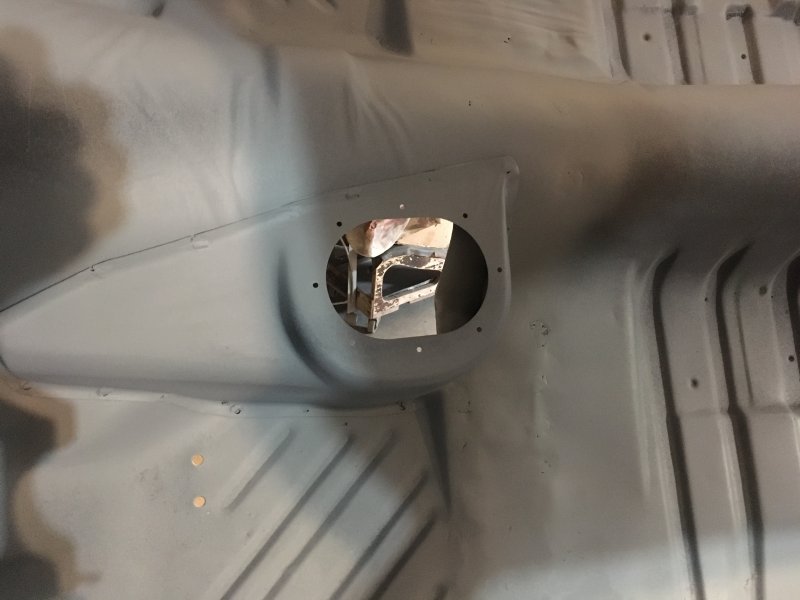

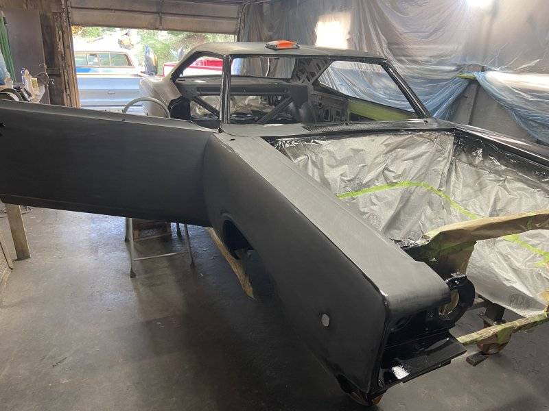

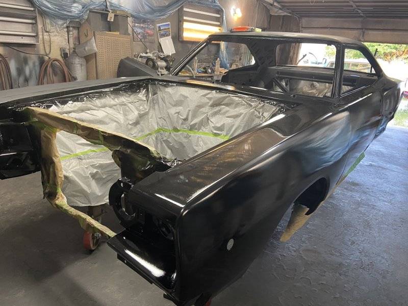

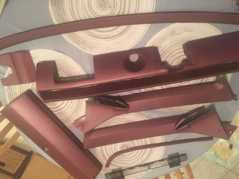

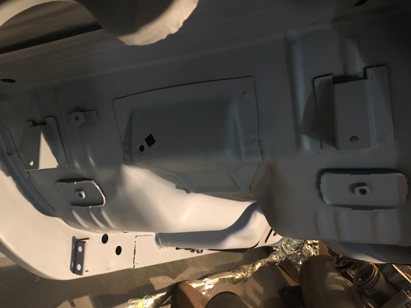

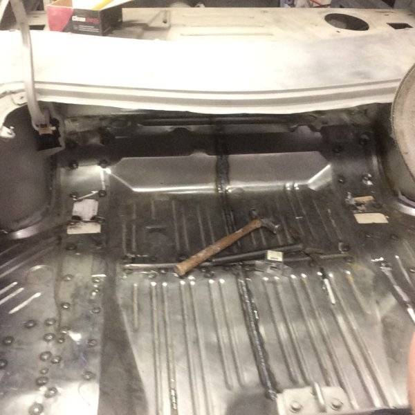

My Coronet has been striped down to the last screw and on a rotisserie for 6 years now. Final paint is nearly done and assembly can begin.
I thought I would share a few pics.

That is a hell of a lot of work. You must be a patient man!
Mike
Looks great. What is your color combo and driveline going to be?
The 68 Coronet is my all time favorite B Body.
I am a bit bias as my Dad bought a R/T for him and a 500 for my sister when they were new on the lot.
Good job !
It was originally RR1 Burgundy Poly with a maroon/red interior (bench seat), but I'm going with black and the same maroon/red interior. I have a 383 ready to go, .030 over, 11.5cr, perf rpm intake, headers. I've also converted the car to manual and have an 18 spline trans. going to use a dana 60 w/ 3.54s. I have several 440 & 400 cores that I may stroke out at a later date.
