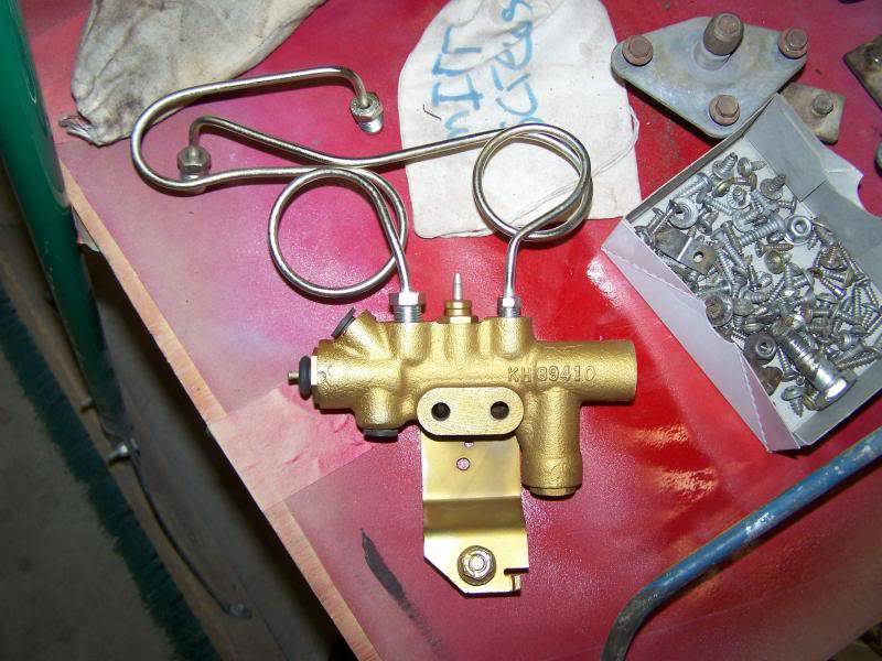

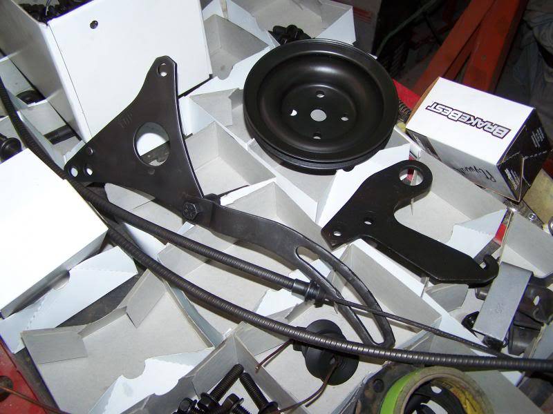

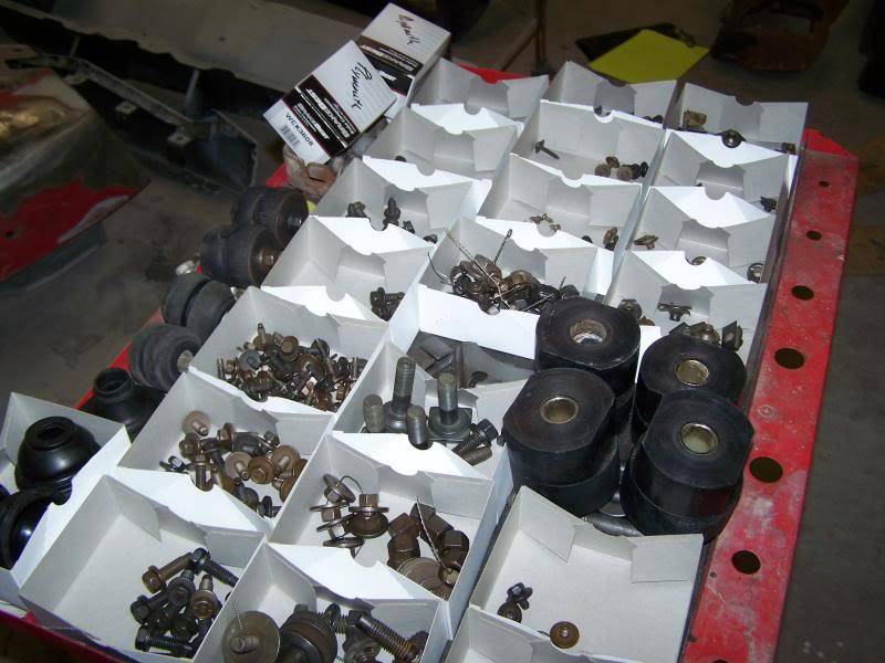

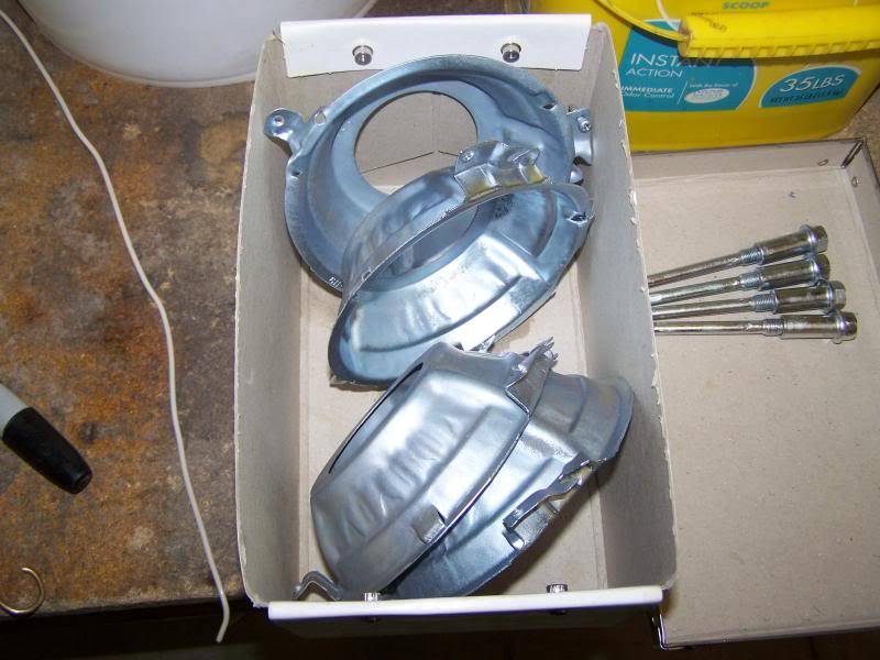

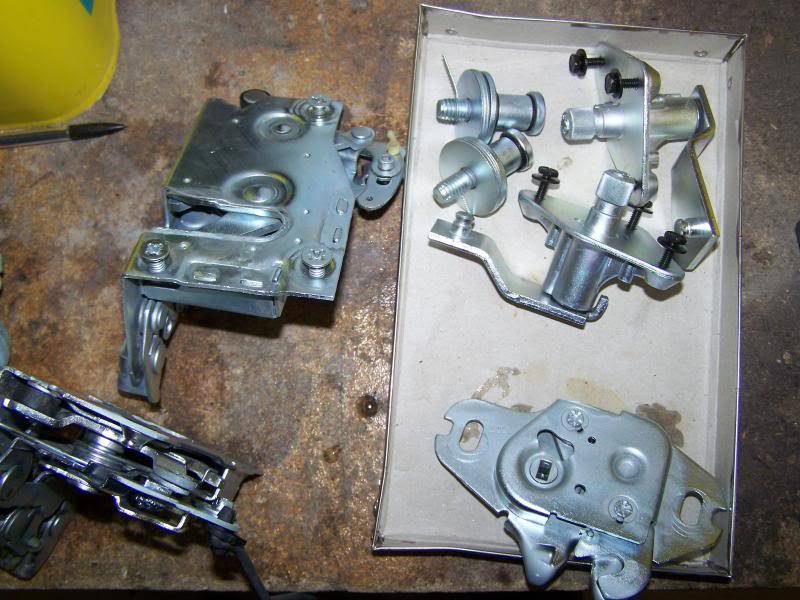

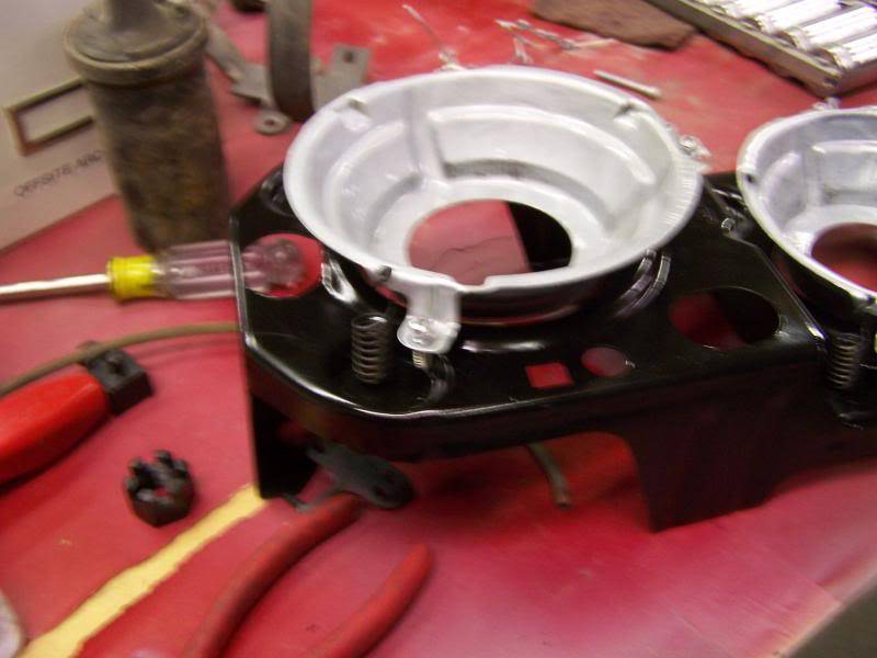

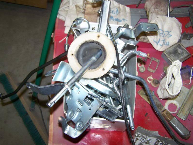

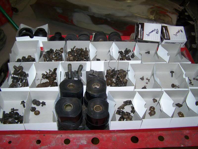

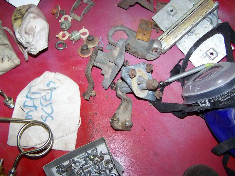

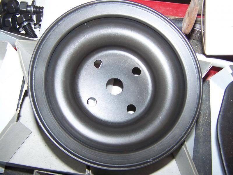

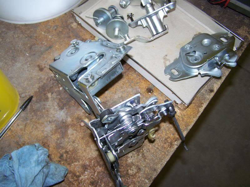

Restored hardware The Black parts are Black Oxide not paint & the silver parts have been plated not painted all labor performed by myself or my partner nothing is farmed out except engine machine work.

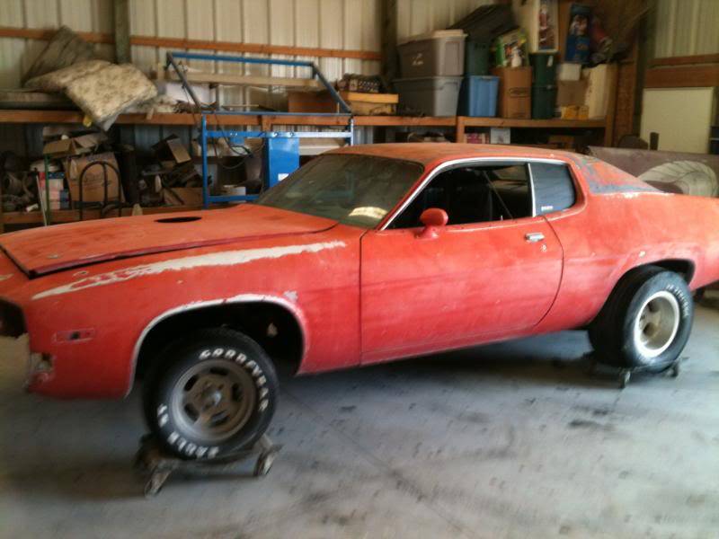

before

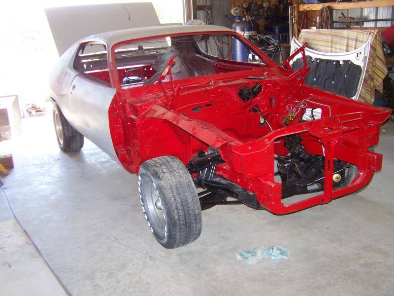

After

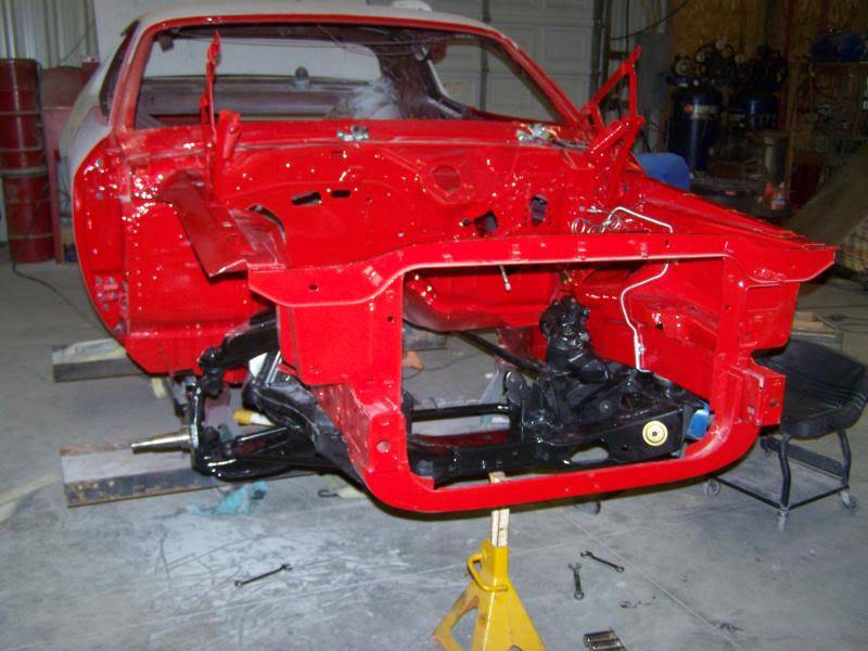

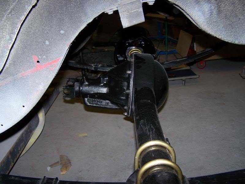

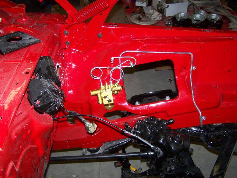

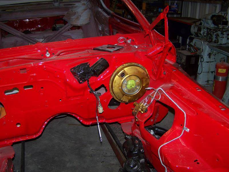

It rolls!

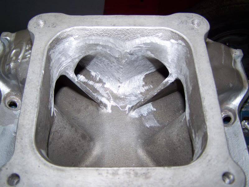

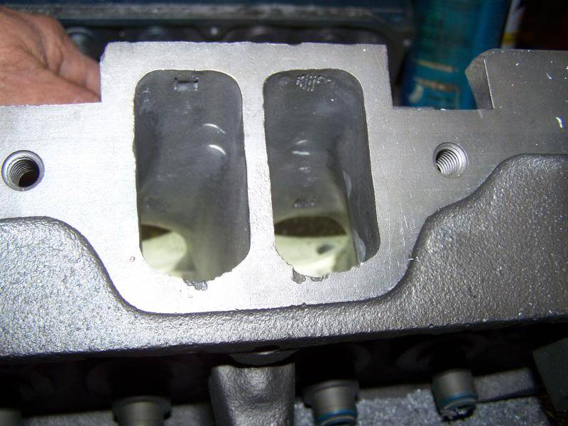

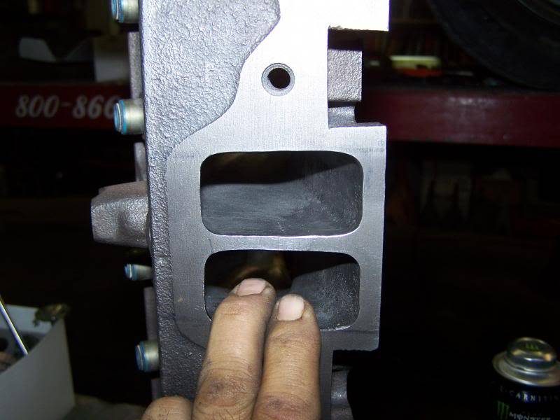

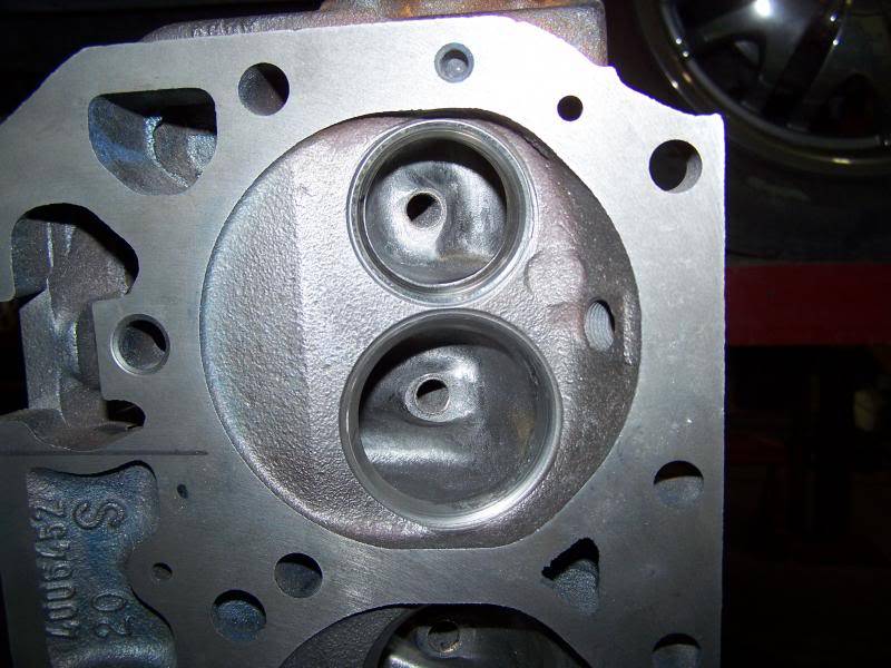

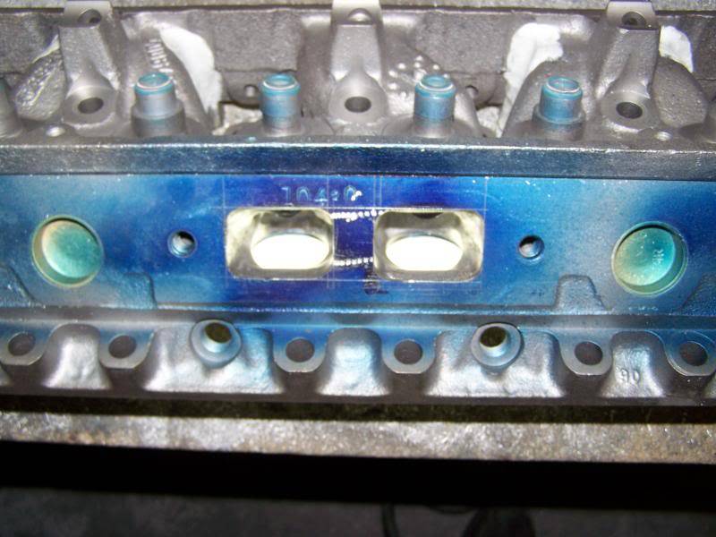

Still got a lot to do to the heads but their coming along

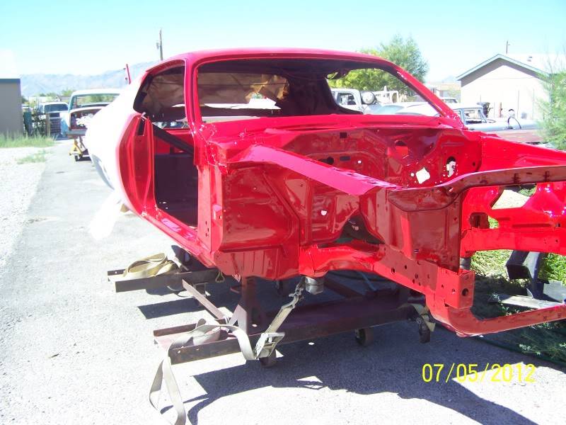

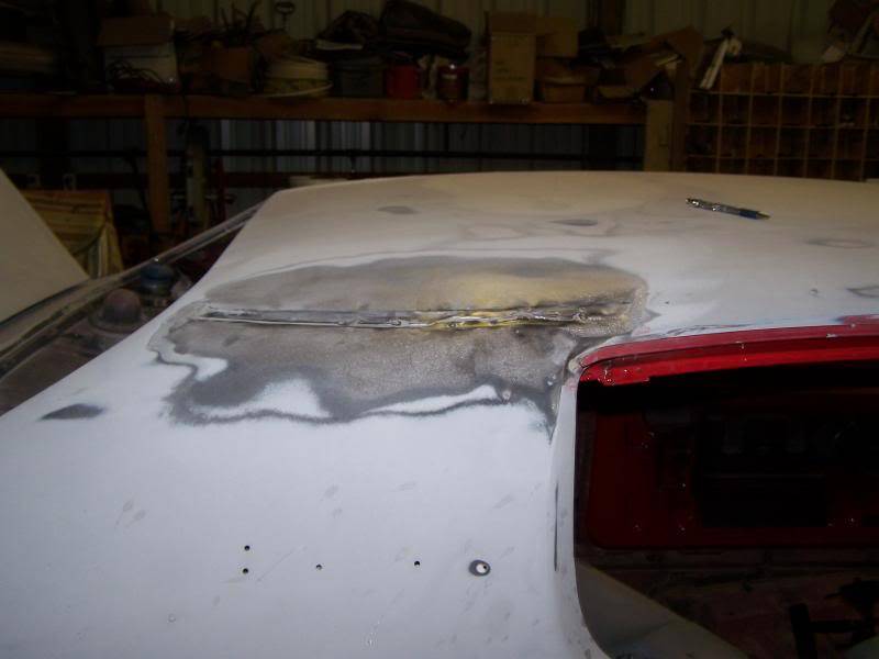

I read a couple horror stories about cracking lead and I decided I better redo this so I stripped it back down.
What are you going to use to fill that seam? I chunked all the factory filler out of mine and had planned on using long strand fiberglass filler due to the thickness of it. I waited too long and it flash rusted so I have to re-blast it, but what's your plan?
Hi Jon
Well I sanded it back down melted the lead out where it was cracked and I have wire wheeled it now I plan to put down some more Spot welds, a couple of the spot welds were broken there in my case and lead was cracking so now after I weld it up Im gonna grind my welds back down sand it a little and put ALLMETAL filler on it followed by some fiberglass filler IF necessary and blend it all in with the roof & paint as normal.

Sweet car, I really like all of the coatings "thought about trying them myself". I like your plan with the seam, I welded mine solid and used fiber strand but now that I've started using All Metal I would use it instead. Keep up the good work

I tell you the plating thing is a another world, I am learning it the hard way (Didnt read the book thoughly!) I made stupid mistakes repeatedly and messed my solution up its not the cheapest way to go and its labor intensive more polishing than I had anticipated to get nice results. The learning curve while not necessarily difficult its easy to do something stupid in process and mess up the solution.
Reading a book on the subject first is very good idea. Or just skim over the stuff tho the book over your shoulders and just go at it like I did. I'm into it now for about $1500 almost for a few parts I could have just dropped off at a Plater for a few hundred.
I really like the Black Oxide for the engine brackets and pullys its more correct than paint is.
I would like to get the equipment and chemicals to do the semi-Hot black oxide its better than the true Hot black oxide or the Cold process in my opinion, the hot is 300 degrees the semi hot is 210 ish, The Hot one (300) is the dangerous one there is also another one that's in excess of 500 degrees but that's using Bluing salts completely different look to the finish on the metal.

great job. I like the first pic withthe wide slots on the back. reminds me of my '73
