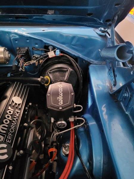

I was having problems with my brakes when I switched to power disc front and drum back on my 69 RR just like a lot of people on this forum that I read about. My pedal kept going to the floor and I would come to a long rolling stop. I did everything to try and fix this, bled the lines at least 10 times and checked for leaks 3-4 times etc.. I had one of those GM MC on and decided to buy the cheap $95 one from pirate jacks, thought to myself this will fix it! Well it didn't it was a little worse and I couldn't get the cap to stop leaking. I read everything on this forum to try and fix it but no go.
I had bought my disc brakes and wilwood calipers from Dr Diff, who was great. I also bought from him a brake block with a proportioning valve built in. I thought to myself that I have quality brake parts on my RR maybe I should have a quality MC instead of cheap piece of crap. I looked at wilwood and found they make a MC for mopars with the four holes but it was expensive. After thinking about it I decided to spend the $350 for the wilwood MC 1 1/8". I installed it yesterday after I bench bled, and also made sure the push rod in the booster was set correctly, which was so easy, it went great. I still need to bleed the brakes but decided to take it for a ride anyway and WOW, What a difference! It had a hard pedal and I could lock them up. Its only going to get better when I bleed them. I spent many weekends trying to get this brake system to work and all it took was QUALITY parts! Wilwood has a great MC and it doesn't leak, looks and works great. For all the people having brake issues you may want to consider this wilwood MC. I got mine from summit so I could return it if it didn't work. Big lesson learned! Now on to my rear main seal leak and I won't cheap out!

So, you ditched the stock distribution block and replumbed that area. Now have the adjustable proportioning valve from Willwood? Did you have to change the pedal to MC pushrod?
No, the distribution block is a combination block/proportioning valve, it isn't adjustable. I think the 70's b-bodys had something like it. No I didn't have to change the pedal to a MC push rod. Used the one from my bendix brake booster.
Okay, so you just replaced the MC, and have the stock distribution block.
Thank you for answering.
No, I did replace the original distribution block, the original didn't have the combo proportioning valve. The one I replaced it with is a combo block/proportioning valve. This is why I didn't need a separate proportioning valve.
