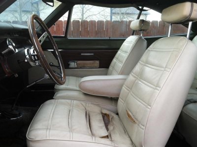

Here is the buddy seat in my 1969 GTX. See my post titled ('69 GTX Fender Tag Questions) that also asks a question on the buddy seat.

thanks guess mine supposed to have that gotta find one of them..i like your car. also
Make sure when you buy one that it comes with the floor mounting brackets because no one makes them repo that I know of.
