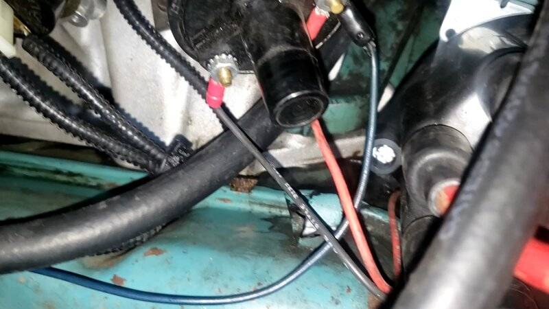

Why are you showing a picture of the coil without a lead in it?
Cause I don't know what I'm doing lol sorry but it's all hooked up just runs like it's missing Sometimes it back fires sometimes most of the time it don't
