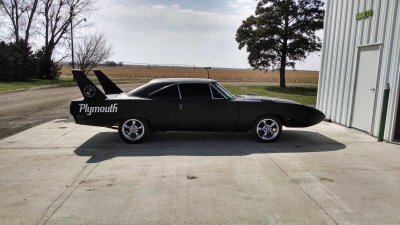

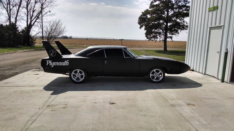

American Racing Torque Thrust two 17x8 4.5" back spacing. Nitto NT555 235/45 front and 255/45 rear. They fit great if anyone else is looking. I know I searched a couple hundred threads it seems before I ordered so I thought I'd pass my 2 cents on.:headbang:

Nice... That pic makes the the car look SR-71'ish...
