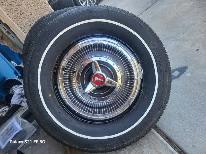

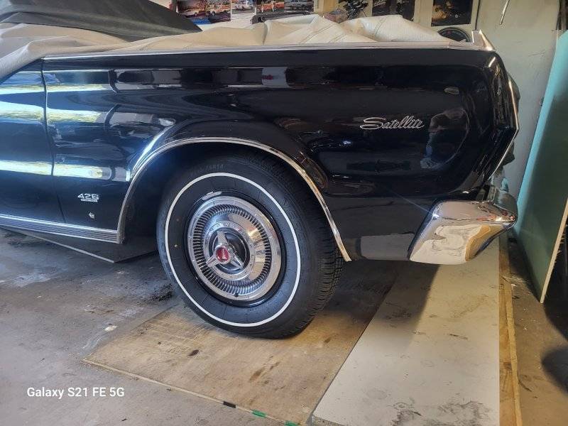

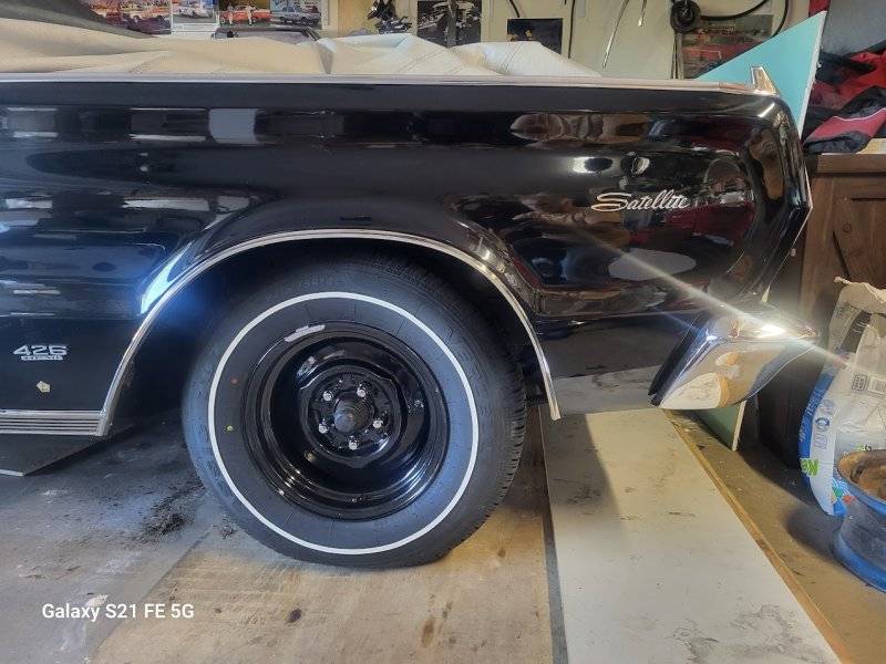

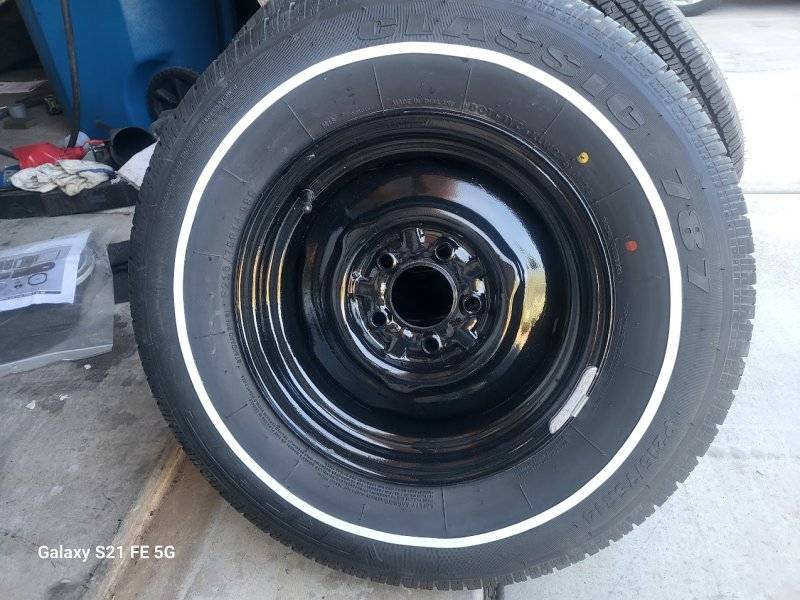

Recently decided to pull the 15inch redlines and magnums . In favor to put the stock rims and wheel covers on the car.
So I bought some whitewall tires and the 1inch wide stripe is just too much.
So found these on ebay and decided to give them a try
Redline tires Permanent DIY rubber kit Set of 4 | eBay
They originally only showed a red stripe in 3/8inch and a 1/2inch white stripe.
So I asked if they could make a 3/8inch white . and sure enough.

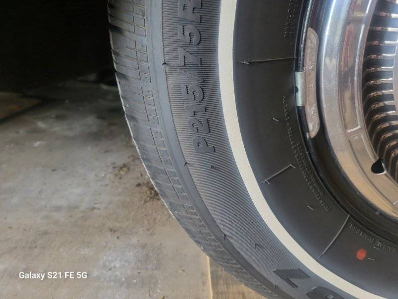

Luckily my tires have an edge I can follow to get the stripe on in something like a straight line. But my 1st one has some small wobbles in it so it will go on the rear where its partially covered by the body panel'
Best advice. ,,,, do NOT pull them in any way to glue them down as you work around the perimeter of the tire
Just apply the glue and let the stripe lay naturally. Trust me it works much better. Work a few inches at a time. I used a small roller to push them down about 5 inches at a time. Let that area sit maybe 30 seconds. Then move on with the next section/ Work slowly,,,but surely
Im taking it to a show Saturday about an hour away.
So fingers crossed no issues with them

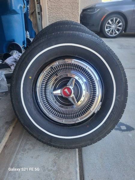

No complaints. I bought them because they were the cheapest whitewall tire I could find. My thoughts were they would dry rot or age out long before i would ever wear them out.
BUT when they arrived the stripe was a little wider than I preferred. I could have lived with a stripe in the 1/2" range. But these were almost a full inch wide.
Thus how this entire conversation of the stick on pinstripes came about.
My goal is swap back and forth between these with wheel covers versus my magnums / redlines combo.
I took it to a C+C event in town and then a smaller local show over the weekend and got A LOT of positive comments on the look.
They are quite going down the road and seem to ride nice. Especially for the money.
I looked at the Hankook's, but didn't like the sidewall and price was a factor for the reasons above
Bought them here - 4 Tires Vercelli Classic 787 215/75R14 98S AS All Season A/S | eBay
I have them mounted on a 6 inch wide rim ( couldnt find the correct 5.5inch hemi car rims, ) Im not worried about the correct rims when you cant tell what rims are on it with the wheel covers installed.

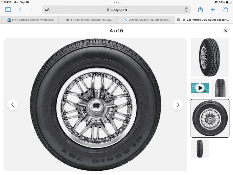

Yes, that’s part of my hesitation on the Hankooks, the sidewalk is busy and may interfere with adding stripes. By the way, I’m using 6” rims too. Had them powder coated a couple years ago.
I would probably start with black walls. It would be nice if they have a mold or ridge line around the side wall to use as a go-by for applying the stripes. Did your sidewall look pretty much like this one on EBay?
Mine have a nice 'RIB' that goes all the way around the tire, Gave me a very nice line to follow so to speak . ( outer edge of the white stripe in this photo)
It looks like the one you referenced, do not have said rib
