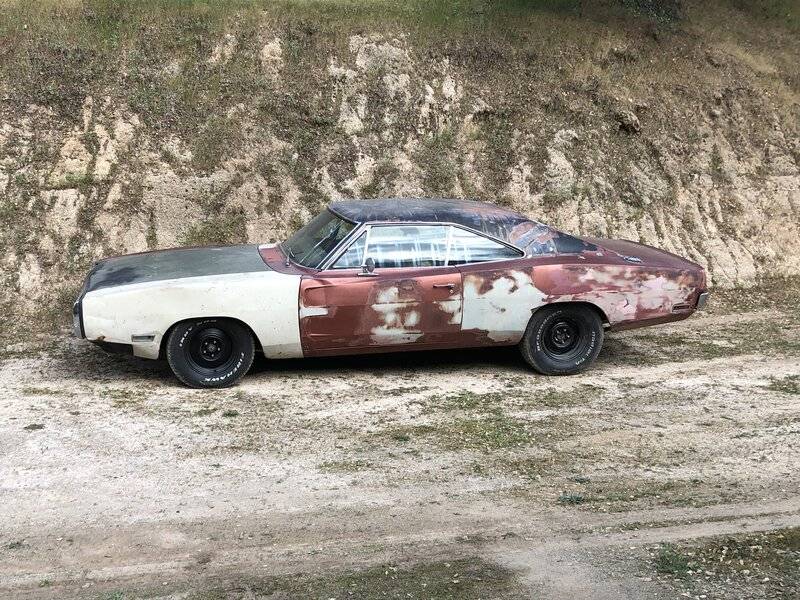

Mystery stains on glass....How do you clean these ??
Kern Dog
Life is full of turns. Build your car to handle.
3:57 AM
Apr 13, 2012
39,045
142,559
Granite Bay CA
The glass has almost no scratches but there are streaks like this on the left side and on the windshield.
I have tried gasoline, thinking it was some type of oil on the glass. I've tried some auto parts store window cleaning paste and even windex....Nothing has worked so far.
Any suggestions? Aftermarket glass doesn't seem to fit as well as originals so I want to keep these windows if I can.

That thing sat under something drippy for a long time?? Like maybe a wet rusty bridge, or a maybe zinc damaged from a rotten roof with a lot of galvanized nails?? Even the roof shows the same streaks. I don't think any birds did that.
Looks like water and rust has stained them over the years it’s tough to remove. Bob Sawyer has posted what you need above.

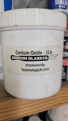

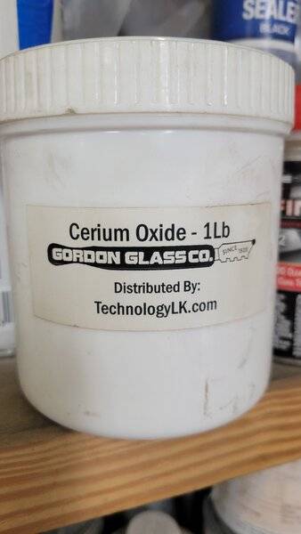

If anyone here wants to use ANY grade of steel wool, please use it on a piece of mirror, and then go outside
in the sunlight and see what you've done to the glass! The Cerium oxide will work just fine. Thank You!
