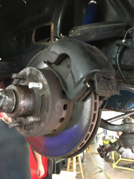

What style brakes are these on my 66 Satellite? Need new brake hoses & these have banjo style fittings.
Late model 73 and up floating caliper single piston. (73’ and up A body)
Seeing as you have them mounted on the rear, 69 camaro with disc brakes is a hose that will work for you.
It would be most ideal if I saw a picture of where the hose connects to the caliper before I would feel comfortable making a firm recommendation..
They do look like the later A-body calipers....but to save yourself any possible hassle, since they are not original parts to the car, take the hoses off and take them with you to the parts store. Or if you're shopping online you can at least match them up by measurements.
He meant mounted on the rear side, of the spindle.
That looks very similar to the calipers on my car except mine are mounted on the front side of the spindle. I pulled my calipers off of an 82 Fifth Avenue.
Calipers should have 7/16-20 banjo and the female end of the hose is 3/8, about 15" long, That Camaro hose is exactly that but so is the 73 Mopar hose
