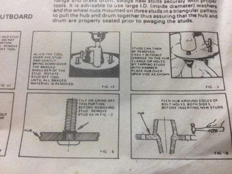

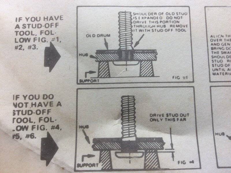

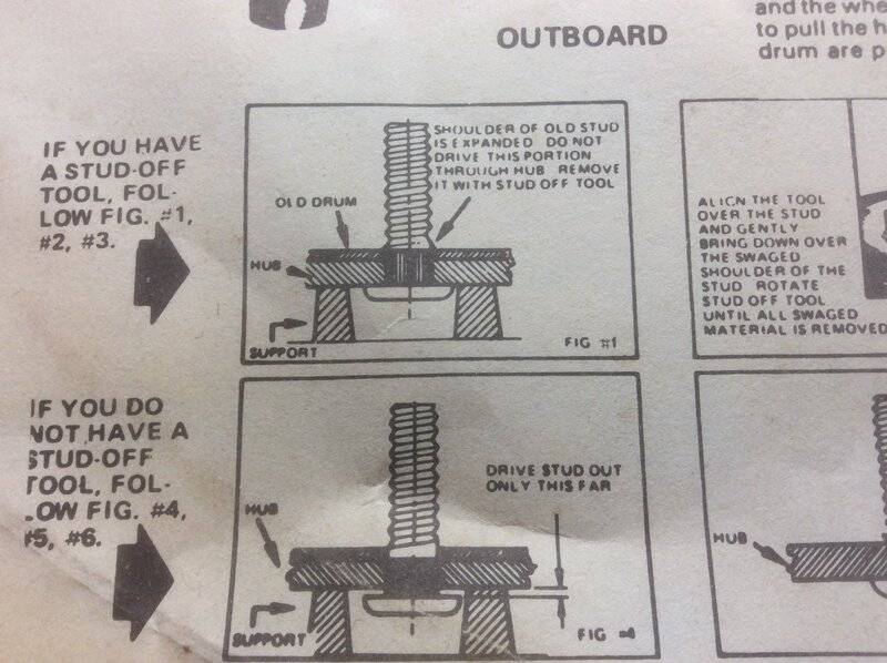

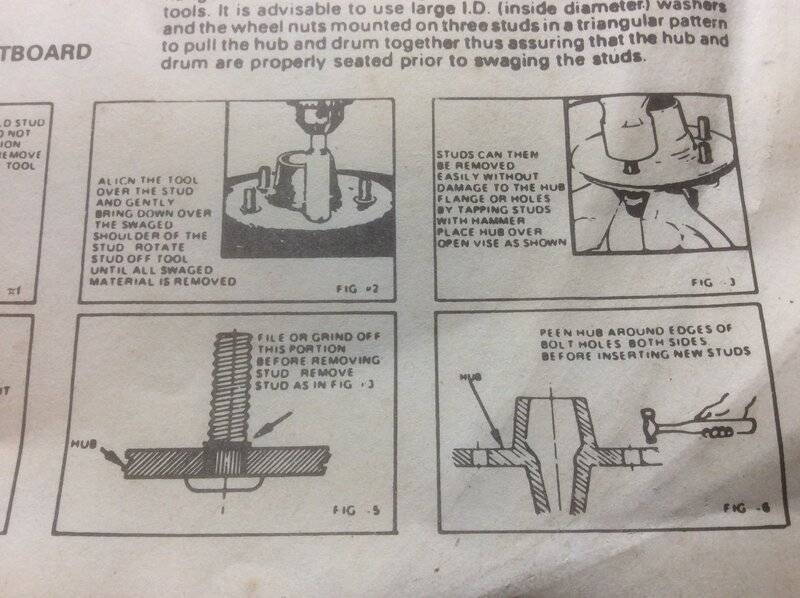

Don't know if these work on 64's. Pics not in order and 2 could be the same.
Thanks Fran but I recently read a thread that gave a part number for the drums and the correct diameter for the wheel studs.
