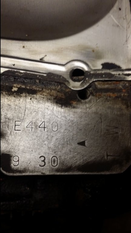

Block looks to be a 68. But the stamp on the pad says?
The right side has an " A T W '.
E(69) 440 Standard block

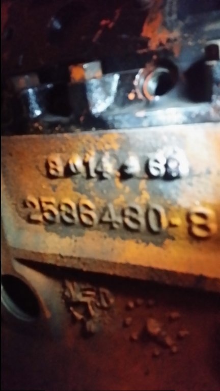

Casting date 8/14/69 looks more like a 9 than an 8
Built 9/30/69
E designates 1969, block was cast on 8-14-68 if I see correctly.
WT = Water Tested
A = .02U" Oversize Cylinder Bore
Looks like 8-14-68 which would be correct for a 69' year built car though quite possible 8-14-69 for a late 69' build
