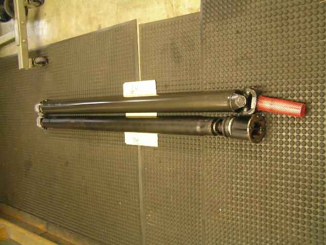

Your best bet is to go to a local driveshaft shop and have one built. It's not that expensive and you get it just right for your application no matter what the set-up is on the car. They will give you a sheet to use to get the measurements. You can also chose if you want it beefed up, stock or ???? Mine was around $200 including the u-joints. I went from a ball and trunion to a slip joint type trans in my '64 Dodge.

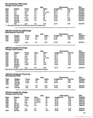

Agreed......Not only are the drive shafts different for 7.25, 8.75 & 9.75 rear ends.They are also different for Dodge & Plymouth Models. If you post your engine size and rear ends size I can provide you with the factory drive shaft diameter and length.

Disagree......do some research. You will find there are several different length drive shafts & diameters for each year of B body.

See attachment for info on 68-70 driveshafts. As you will see there are many different combinations.
