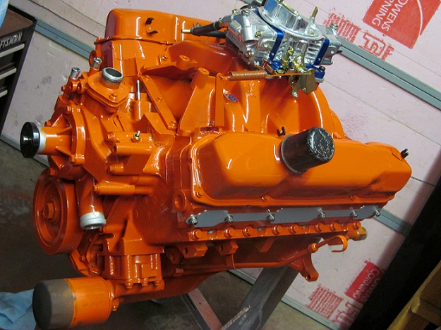

On my 505" stroked 440 I did some port clean-up and multi-angle valve job to get a true 290cfm out of the Stealth heads. I used those to try make it look more stock?

451Mopar your eng looks real good. I wanted my eng in my 63 to have the Max Wedge look as much as I can even though I am not using a crossram. Ron
