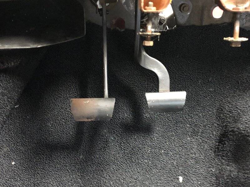

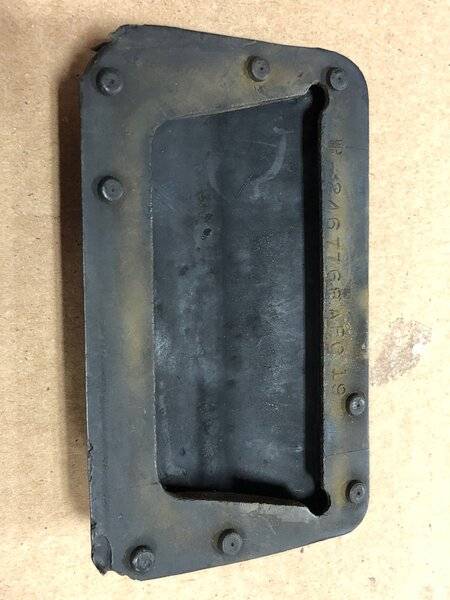

Guys , in searching my parts catalogs no one has a clutch pedal pad listed for any 71-74s. Seems they all stop at 70. The pedal is smaller than the brake pedal so that pad won't work. Anybody know anybody repopping them...thanks....

bee71 are you saying you know for sure pads listed for 71-72s do indeed fit 73-74 models? Lots of folks list them for 71-72 but NOT for 73-74s. I only have a 73 so I don't have anything to compare it to. True there were not a lot of manuals made in 73-74 but I m sure others have them also. I can tell you for sure the brake pad will not work on the clutch pedal...done tried that.
Something is wrong there because they should be the same pad.
Yes 71-2 are different than 73-4 which are more square.
Should be relatively easy for the OP to look at his pedals and see if the metal is rectangle or trapezoid.
Thanks guys, you members here rock. I was wrong in saying the two pedals were different, they are the same. mopar marks was dead on. Seems I was trying to get some GM pads to fit and got it that they were different sizes. I finally found the one pad and it looks the same as those posted at megaparts. The classic industrial catalog show a repop clutch pedal assembly they sell that is modeled after a 70s pedal. Those pedals look like mine.....so I think 70 pads will work. Thanks all
