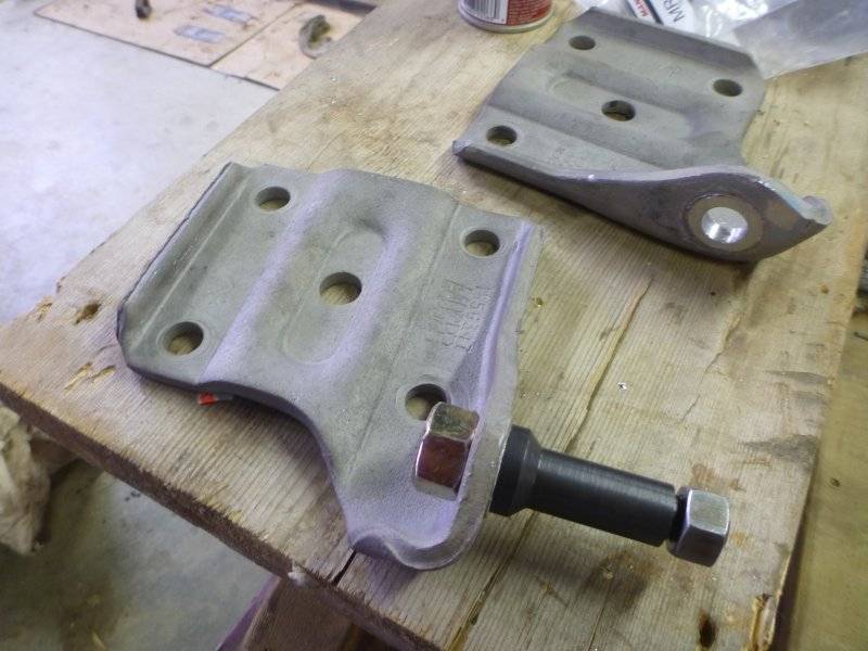

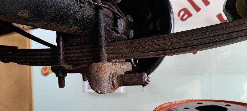

Guys - I'm needing to replace the Bracket that is used under the leaf spring. The U Bolts are mounted to this bracket as well as the bottom shock. See pics for details.

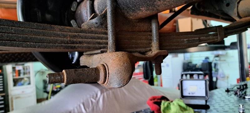

This is the left side. If I can find a source it would same me the trouble of building something the right way. The shock nut was tack welded to the shock mount. I didn't think I'd get it off without breaking. Here is a pic of the right side also.
It needs help as well.

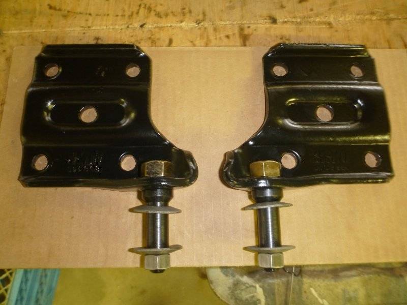

They come up for sale here. Start a Parts Wanted thread. Someone has some they would sell you. Otherwise try Dr. Diff or may be Mancini.
I'd imagine most of the usual Mopar vendors ? Tony's. Ted Stephens. Moparmarks !

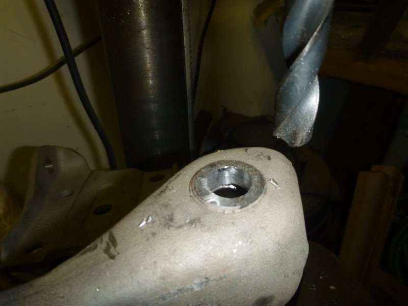

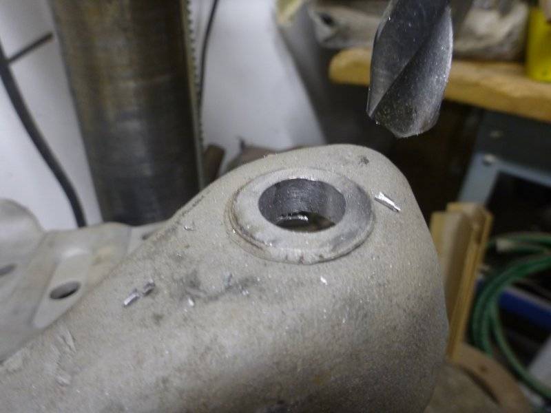

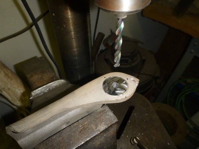

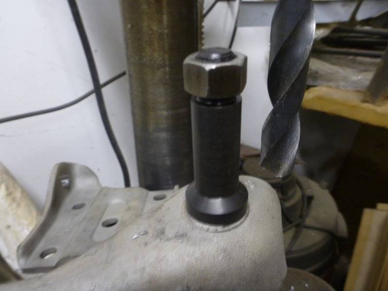

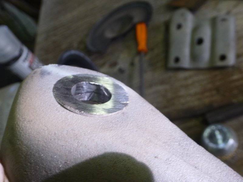

A WTB as Mike alludes to will probably get some by days end here. That said you can also replace the stud....
