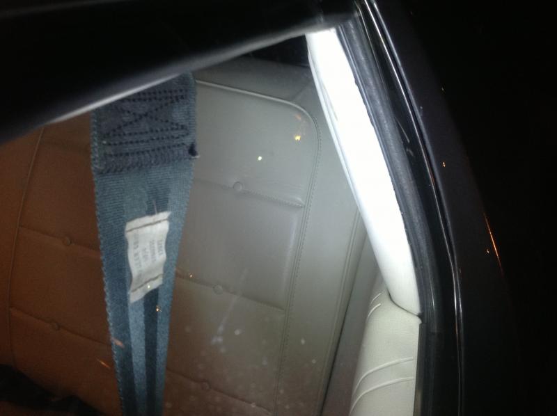

Hi, I have a 1973 RR and am redoing the interior. Before I get too far tearing it all apart,
I was wondering if someone could help
identify the part(s) that are missing from this picture? :eusa_pray:
vbpgimage.php
I have stationary rear windows and I need to purchase the "rubber" or what ever that goes in between the
window and the rear sail. Both sides are missing from the last PO rebuild. I have looked thru my manuals
and can't seem to find what goes here. I have been watching many great rebuilds on the forum and just know
someone has the answer.
Thanks in advance Dennis.
Are you positive something goes there?
Do you have a bigger picture? Try Steel Rubber Products.
You are correct. There is a widow seal that goes there that actually clips to the edge of the seal. It usually comes as part of the seal kit and never gets installed because they are a pain to put in and have stay.... The new clips ( when they come) never fit quite right... Ended up gluing mine in.
Heres a picture of mine....
Hope this helps.
Yep, that's what is missing....do I need to get the whole seal kit? If so, can you give me more info on where to get it and what I really need to ask for?
Thanks

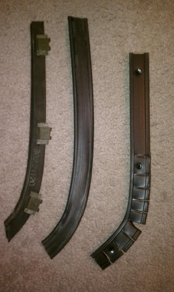

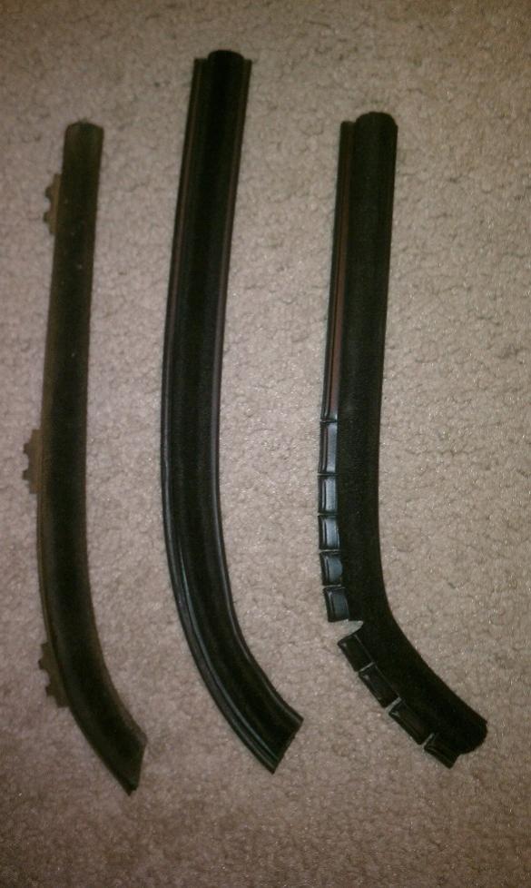

Those would be inner belt moldings, you can get crappy ones from year one, or call Dave at Restoration Specialties and get a set. A complete kit comes with inner and outers that go on the door and quarter glass, plus inners that go on the door panel, rear panel, and sail panel.
FYI Steel Rubber will refer you to Restoration Specialties.
Here is what they look like, from left to right, original, restoration specialties, crap year one actually made by "First Place Auto Products".
I will have to call Dave tomorrow and ask why his don't come with clips. That's the only issue I have seen otherwise his quality is top notch!
