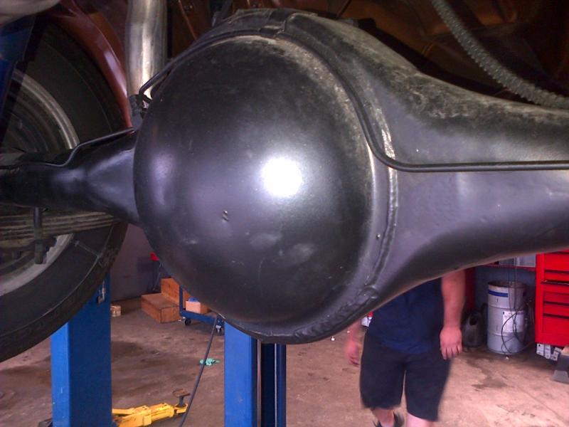

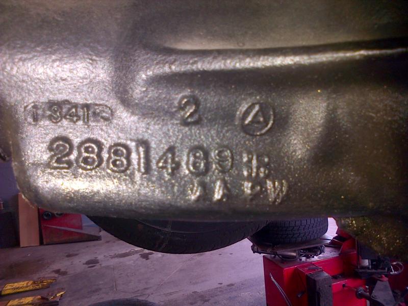

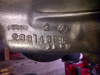

Can anyone help me with identifying what rear this is? Right now it's on a 69 RR. Thanks
8-3/4 rear axle housing 489 carrier with 1-7/8 pinion 69 to 74
Ok, so should be correct for an early January 69 build 383 RR?
Yes the 440 and hemi came with the Dana 60 unless you're build sheet says different
I thought only 4 speed hemi and 440 came with Dana standard.
Standard yes the 440 4 speed and hemi 4 speed got dana 60. 440 auto and hemi auto were 8 3/4 standard.
You could order a 440 or a hemi automatic with dana 60 in 1969 with the super track pack option.
