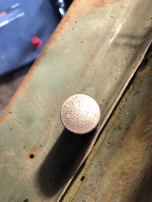

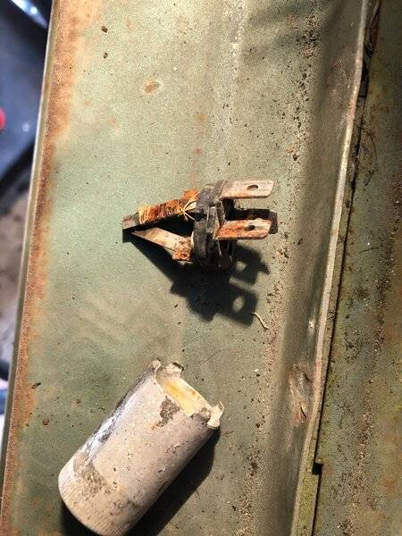

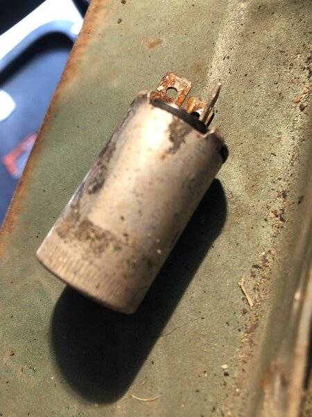

Sorting out the electrical on my 69 Satellite. Came across this relay? or switch? Pink and yellow wires going in and a wire which I believe goes to the heater box coming out. There are no marking other than “made in USA”.
Trying to identify what it is so I can replace it. Any help appreciated
BAA3308C-10AE-47F6-AEF7-B75B244AC01A.jpeg A40F9577-7F00-442F-9D73-5C04E2151CB5.jpeg C3B9211A-2B38-436B-9627-D1BB2D6440A8.jpeg
Ignition switch courtesy light delay flasher. Its available new on $8-15 at several parts stores. Mostly sure still available at Mopar dealers under Chrysler 2889565 PN on $40-50 LOL. It was used up to 90s Mopars/Jeeps
Awesome thank you!!!
