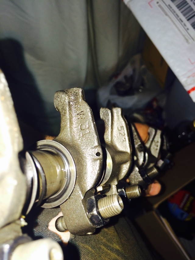

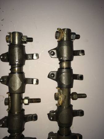

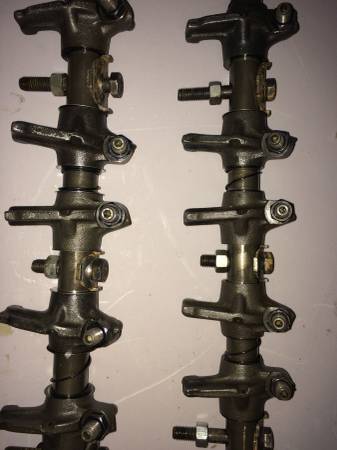

Need help identifying these ductile rocker arms
Banzaiii67
6:51 AM
Sep 24, 2013
380
160
Milwaukie, Oregon
Found these locally forsale for a decent price. They don't appear to Crane or Isky.
Are they Erson or Mopar Performance??

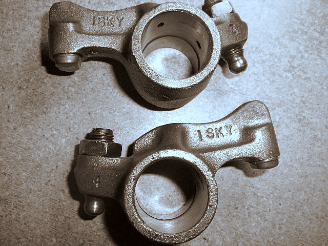

Cranes? Isky has a similar set but their name is on (iirc) them plus they have contact pads for the valve tip.
Like these.

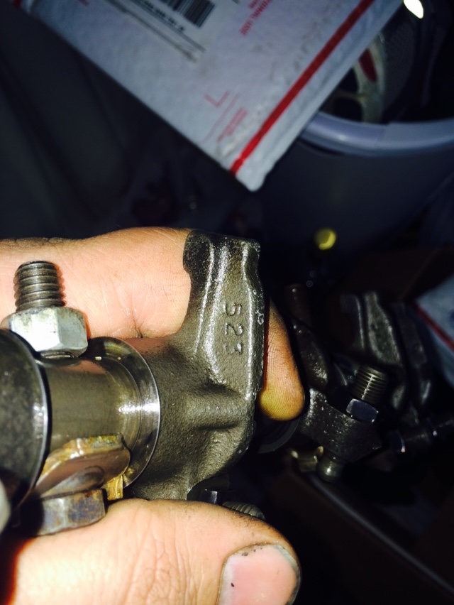

I asked the seller if they had crane/isky engraved on other side, he said no..
Cranes were usually engraved on the bottom see picture above, Isky were on the arm.

Those are factory Max Wedge type and/or any early engine with solid lifters. Good rockers for a mild performance cam. The price is OK if the bores aren't gouged up, which will be a rare find. I'd offer $150.00
I ended up passing on them, seller wouldn't budge on price even though he didn't know what he had. Thanks for all the responses!
Found a brand new in the box Isky's for 100 bucks at a swap meet several years back.....grabbed them quick too! Probably sell for 200 in today's dollars.
depends on how good the fulcrum area is. all those ductile iron rockers have fulcrum issues. also depends on how much lift the cam has. iron rockers have geometry issues at higher lifts.
I ran the Isky's for years with .585 lift & held up well. We cut the diagonal grooves in the shafts. The tip contact pattern wasn't the greatest though.
I would like to see how the grooves were cut. I am working on my ductile rockers now and would like to put grooves in my shafts.
