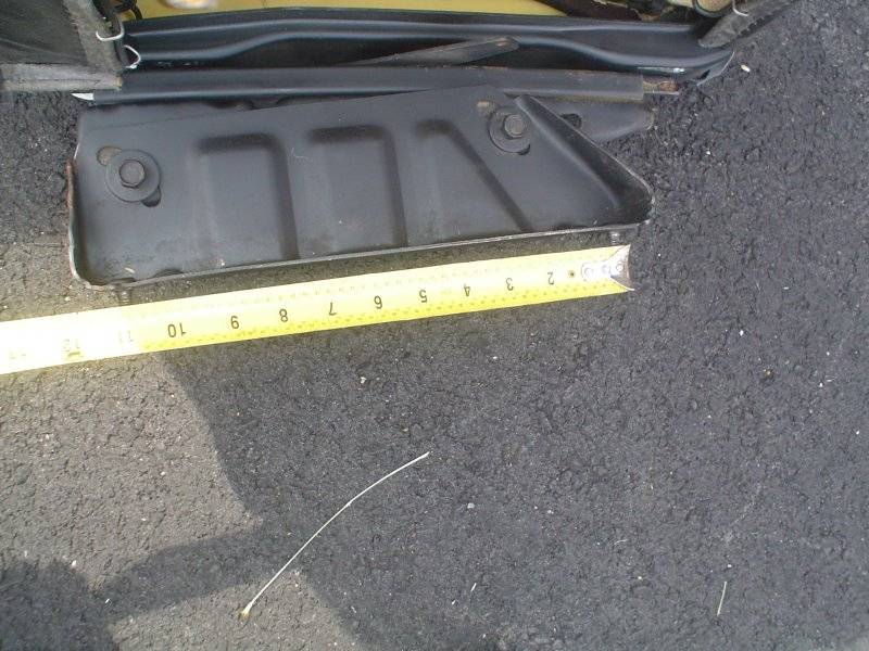

Inside and outside studs are 11” apart. I would recommend putting a replacement plate the floor for each especially if you are going to drive it hard.
These are exactly like mine with the adjustment slots. You can tell the inside track studs are more narrow than the outside. My problem is not knowing where to drill the inside holes. I already have several holes to weld up. Does anyone have the hole spacing for a 66 B body? Thanks 440

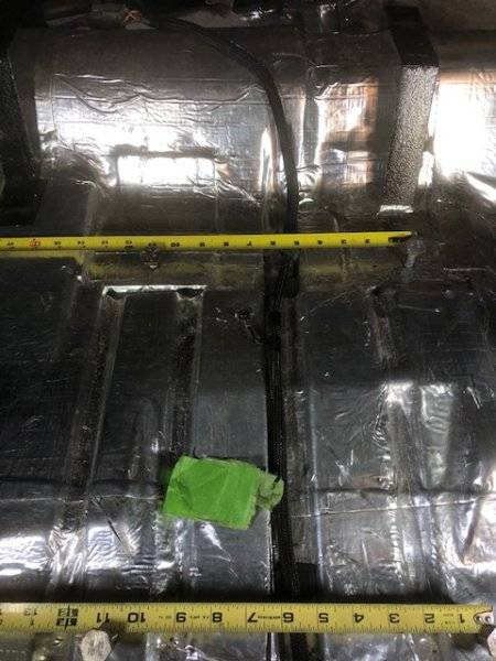

Right now my floor is covered by sound deadener. Both inner and outer track bolt holes are the same distance apart front to back. I would think that if you were to make sure the back inners lined up you would be close . Again my inner and outer track studs are the same distance apart, so are different from yours. What was the design of your seat covers?

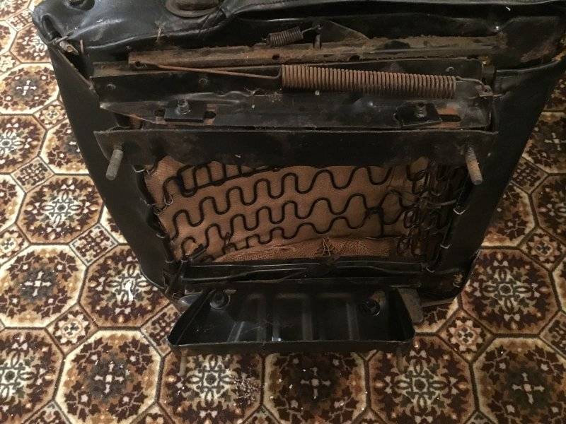

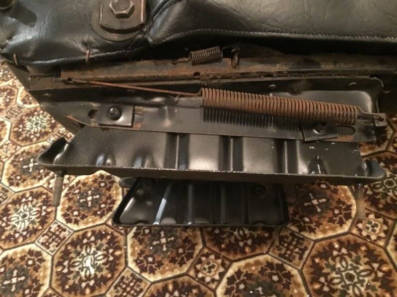

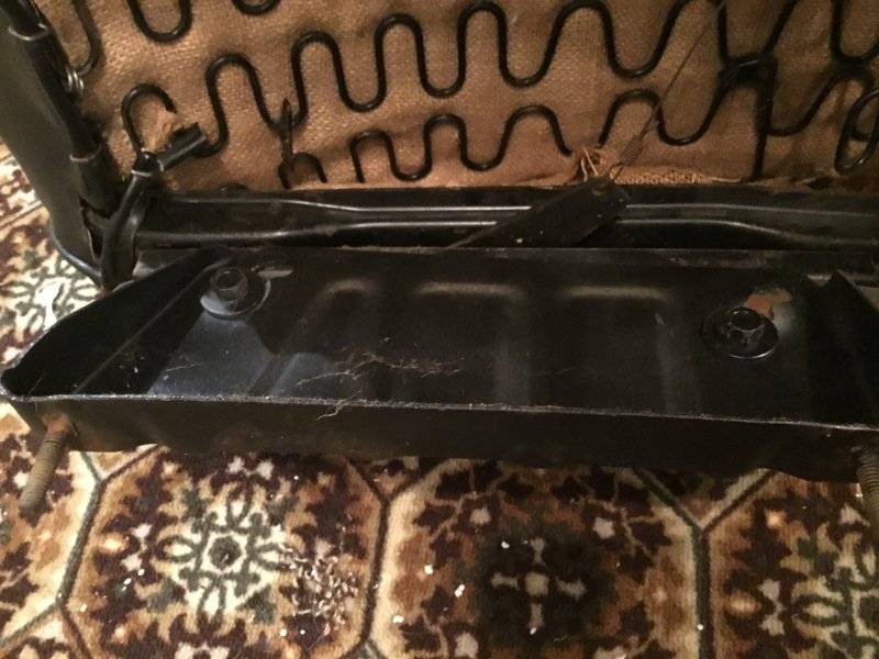

I bought these seats before I moved about ten years ago. They were sold as 66 B body seats I had no reason to believe they were not. The upholstery is long gone. Here is a picture of the seat tracks. The tape is on the inner track in the first picture. Thanks
I have taken a few more photo’s. If your seat backs are like ours, that is a 66-67 back. B body. I tried to take track pictures like yours. Your lower bracket might possibly be from an A body.
Try and compare to my pictures.

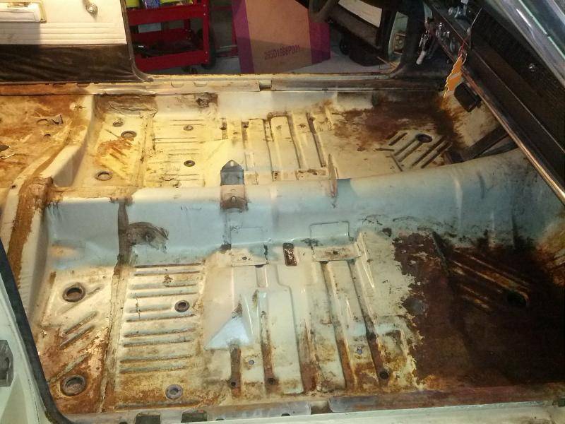

Look at the picture of the white floor, post #8. that will get you close. The floor has dimples when the holes should be drilled. All bench seat cars, 4 doors & wagons. You may not find them with your sound dedner.
