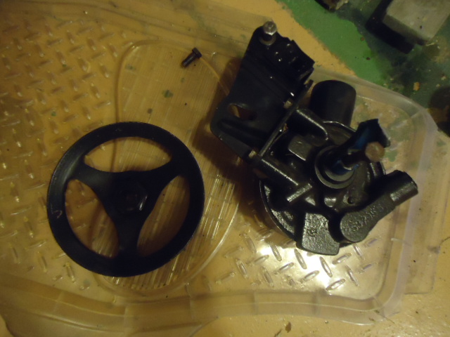

I have a power steering pump rebuilt several years ago sitting on a shelf. I used a gear puller to remove the pulley way back then. I am finally getting around to converting my car steering. How the heck do I press the pulley back on????? There is no keyway on the shaft. I was thinking of just sticking a screwdriver in the fill hole and blocking the pump from moving while tightening the bolt, but there has to be a better way. Any suggestions?

what type of PS Pump do you have...? Thompson is a little tricky..you´ll need a special pulley puller..and a press to reinstall the pulley
This one.
Anybody able to tell me what kind pump I have? Thanks in advance.
