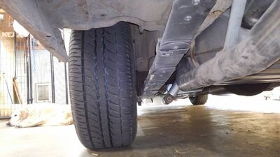

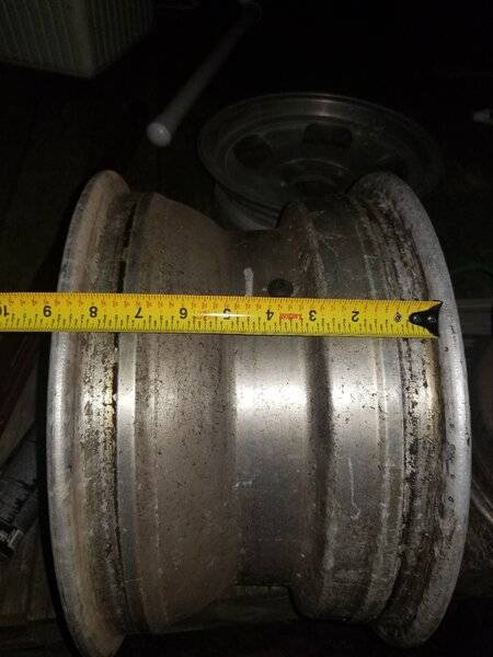

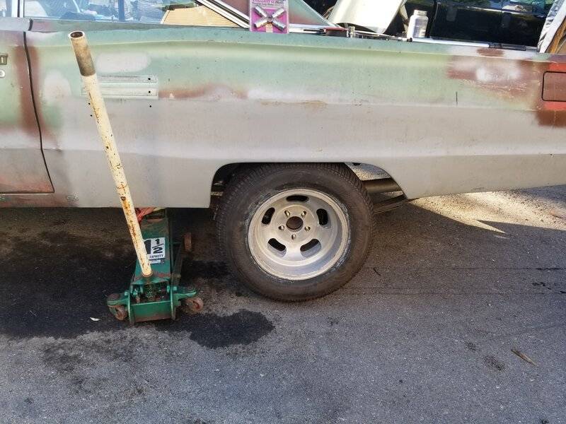

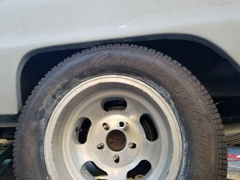

I have a 1966 Coronet I am trying to find wheels for. The slots we purchased ~20 years ago for this project (now lovingly referred to as "Long Time Coming") I find will not work. What I am measuring:

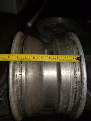

15" x 8" wheel with 3.25" backspacing

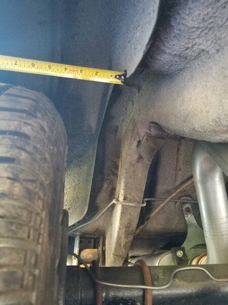

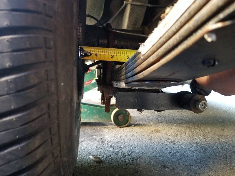

Looking at it on the car - it looks like I need an additional 2.25" for a total of 5.50" of backspacing to fit under the lip of the wheel well and also still clear the springs.
Is there a slot wheel out there with this much back spacing?
The tires are Cooper Cobra 255 60 r15's. I know I've read that this tire is a common used size for the back of the 66/67 Coronet and was hoping to use these wheels, but the offset is clearly not going to work.
Thanks for any help in advance.

I just put 255/60-15s on the back of my 66 Charger with 15x8 cop wheels with 4" backspacing, fit great. My tire to spring clearance is about 1", I just don't see how you could possibly use wheels with more than 4 1/2" back spacing if leaf springs are in stock location.
Man, going to 4-1/2" backspacing would only give me an additional 1-1/4". It doesn't look like that would get me there.... If I could get some wheelwell/tire info pics from some that are in-use - that may be helpful.

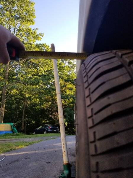

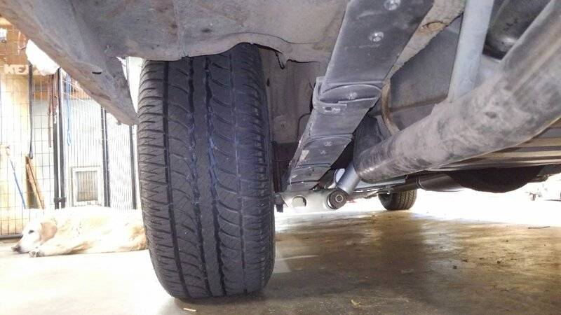

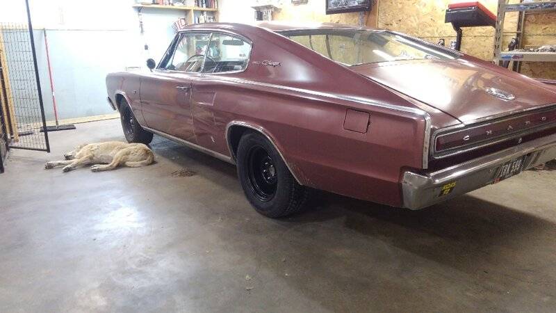

I know your Coronet wheel openings are not the same but here are the 255/60-15s on my Charger with 4" back spacing wheels, I previously had 235/60-15s on 7" wide 4" backspacing wheels and since I didn't already have the bigger tires mocked up on 8" wide rims I was too nervous to order the 4 1/2" because of tire to spring clearance. I will try and get pictures showing tire distance to spring posted later.
Here is better picture showing my spring to tire "bulge" clearance with 4" backspacing wheels, it measures 1 1/8". So I assume 4 1/2" back spacing would put it at 5/8"

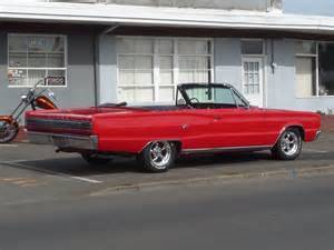

I have 15 X 8's on my rear, with a 5 1/4" back space using 245 60 15 radial TA's on my 67 Coronet... If I was to do it again I would have them made with 5 1/8" back space.....
