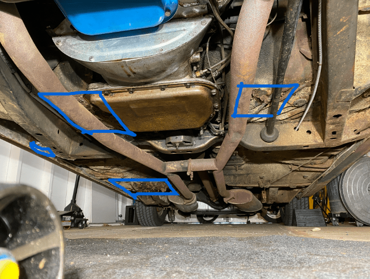

I don't see anything that needs to be done immediately in that picture to use the vehicle.
I've seen cars look way worse than that one that had no issues for years.
Thanks that's encouraging, always good to get perspective. I'll have the car on a lift soon and will take some better photos. There is through-rust in the floor pans and in the quarter panels and wheel arches. I'd like to patch them in simply to keep the water out and put some miles on the car but I'd be interested to see what other think in terms of how viable the car is for restoration with more photos posted.

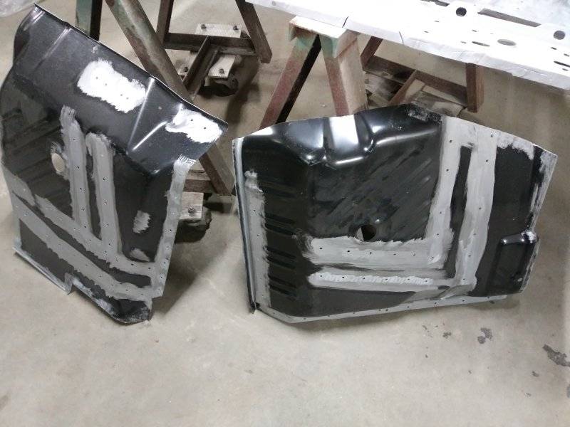

the patches are always bigger than they appear....... you can buy half pans and use what is needed; it's best to go all the way to the firewall and clean those rails and cross member out......... do it like this and be done for ever IF the rest of the pan isn't bordering on swiss cheese
@eldubb440: Thats great looking preparation snd nice work. Also thanks for posting those photos it’s very helpful to see the floor layout.

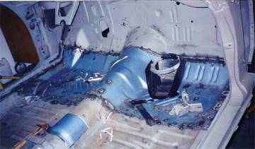

What I did on my Coronet.... Mine looked rusty but actually there wasn't any rust through and very little pitting.... What there was is a huge hole from the original owner installing a 4 spd.... I'm not sure if he used a Hatchett... Or a hand grenade....
Anyway, I cut inside the torsion bar crossmember & trimmed back the the forward edge of the rear side of the crossmember.... That gave me access to clean and paint the inside of the crossmember but also left the rear floor fully supported.. And then the new front floor section laps over the rear floor....

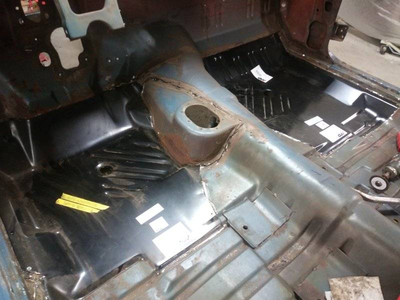

@1 Wild R/T
Thanks for posting those photos. Looks like you used metal from a donor car right? Was that due to availability or preference? Curious how well repair panels metal fit.
Your repair also looks like it might have been tricky to cut and fit given it included the transmission tunnel. I’m guessing you had much of the drivetrain out of the car..

I used the floor section from a four door because it was all ready getting cut up as a donor for another car..

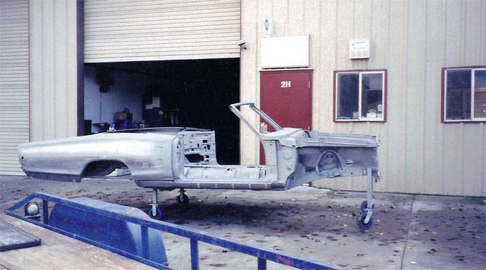

My Coronet was stripped to a bare shell...
There was not problem at all fitting the floor, dropped it in, marked the locations where it rested on the frame rails, rocker boxes & rear crossmember/floor pulled it out & drilled holes in the floor so it could be plug welded... dropped it back in place, Used clamps to pull the firewall seam tight then used self tapping screws to secure the floor to the firewall, rockers & frame rails.... Then started plug welding the floor in place.... It really wasn't hard... I don't do final body work, I find guys that can do that... But fitting floors? not to difficult & a great place to learn cause if it doesn't turn out perfect you can use seam sealer to seal it & hide it under carpet.... Though honestly you'll find it's not hard to make a 100% acceptable repair...
Thanks for that description. Always impressed when I see progress photos of fully stripped down car built up from bare metal.
