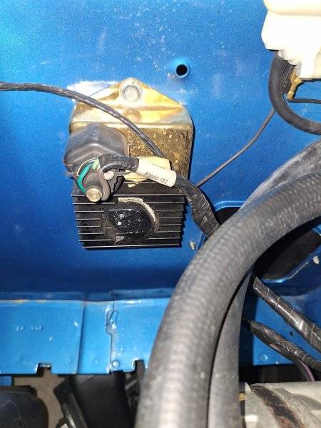

Thank you for the info i did forget to tell everybody in my earlier post my car dose have the Mopar performance #3690432 electronic upgraded ignition with the gold box so will these still work on this. Don't mind spending the money just don't want to do it more then once trying to keep my car as original as possible visually it is 98%

A Mopar Performance Gold controller
(as you call box/I assume you're referring to, the ignition box)
or Direct Connection Gold (RACE) 'Box' controller isn't a 'street box'...
it's not intended to be ran more than 30 min.s at a time,
it's race only or don't run it long it will fry the transistor on top
& the controller CEI 'box' requires a/the proper coil, matching the low ohm resistance...

Thanks for the info as far as the box i assume this is the gold one all i know it was on the car when i got it 8 years ago and i have drove it several hours at a time with no issues. Hear is a picture of it just so somebody can confirm maybe it is not the race version i know it has a black heat sink on it. Yes the carburetor is the correct one per my build sheet the air cleaner is also correct i just installed a Glen Ray radiator with correct numbers as well as the correct power steering cooler as i said it is not 100% and probably never will but as i replace things i am doing it correctly so i get closer everyday.

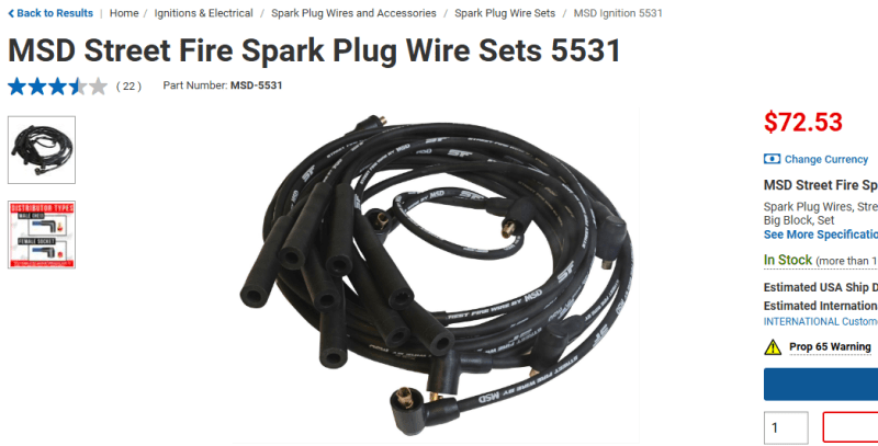

When I said black, I should have said decent quality also - I am sure they were the MSD leads -
1969 DODGE CHARGER MSD Ignition 5531 MSD Street Fire Spark Plug Wire Sets | Summit Racing
