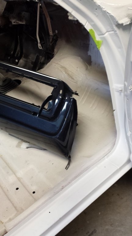

Please take a quick look at an installed dash frame in your car.
I'm sure the frame goes inside of the door frame (green tape).
I just want to make sure before I install mine today.
It seems to have grown and will require some adjustment now that I've sandblasted and painted it.
Bending the dash frame sides inboard to clear will be necessary if that is where it goes..

It goes out.
Oh. Wow. That explains it being so "wide".
Do I need to wait till I get whatever goes around the door frame lip installed to put the dash frame in.
The frame looks like it would "capture" some kind of seal there on that flange.
Maybe some trim?

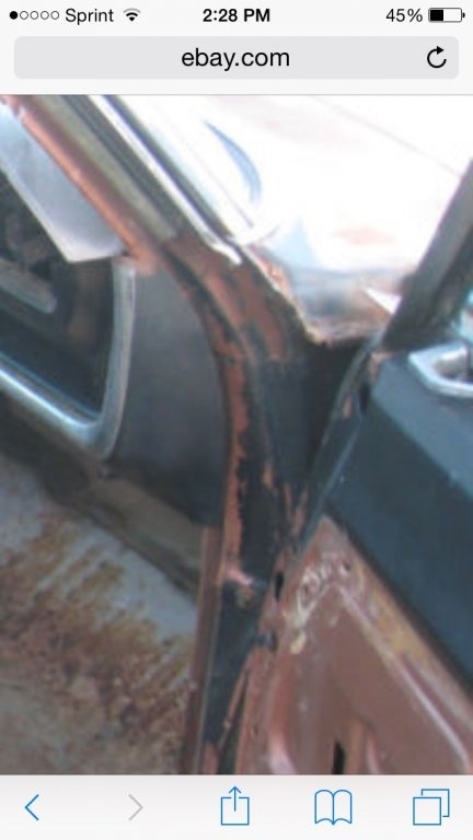

Mine is a 69 bee and goes out. I'm at work and can't take a pic but here is a pic of a 67 Coronet.
I found all the trim. Goes outside
Thanks now I can get the column in tomorrow.
