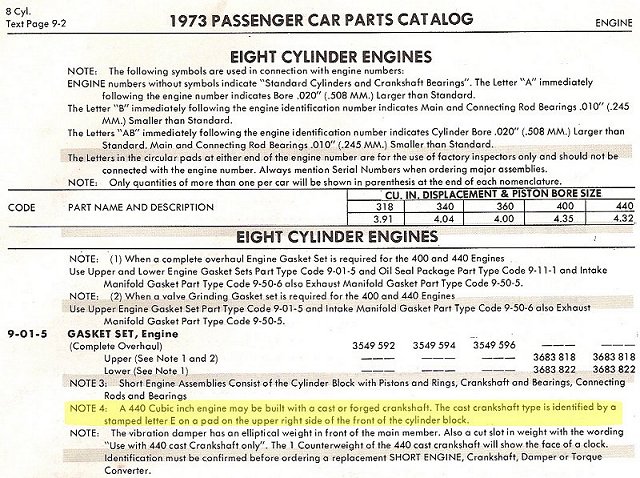

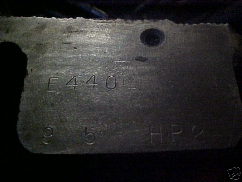

"E" = cast crankshaft
In this case the "E" represents the year of car the motor was used in.

The model year designation comes first. In the case of a 69 model year car, the E would be before the CID.

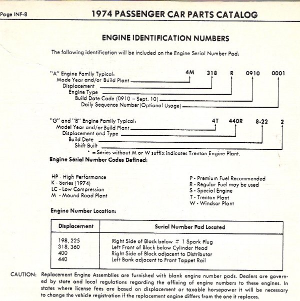

In the case of the original poster, the 4 comes first telling us this engine was for a 1974 model year car.
The "T" tells us it was assembled at the Trenton engine plant, the 440 tells us CID, the "E" at the end tells us the engine came with a cast crank.
Some sources cite the "T" stands for a truck block and it does, if the "T" follows the CID. If it comes before the CID, it stands for Trenton engine assembly plant.
