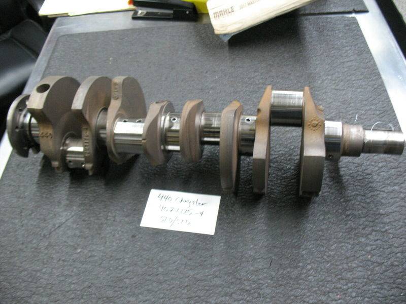

452 heads would be period correct. A cast crank will have 440 embossed into it. I dont think the forged cranks has the 440 embossed into them. Here is a picture of a cast crank for a 440. Your rods are what are referred to as 6pak rods. So I would think the forged crank is legit with the 6pak rods. I bet your engine came out of an RV and thats why it has the heavy duty rods and a forged crank. I wasnt that lucky with my 75 block.. It had the plain old 440 rods and a cast crank.
As I mentioned before, the heavy- 6 pack rods need to be externally balanced or have heavy metal added to the crank to internally balance it. Keep that in mind.

I have read that this motor has the six pac rods but the factory used lighter pistons and keep the internal balance
They are also low compression pistons I bet. So they sit lower in the hole. Like said above J=73, CU 440, T=Trenton plant. Look a little more on that pad for other letters or numbers.
I have had/ seen many 440s with steel crank and 908 rods and they are NOT externally balanced. The first 1 I had was a 1970 440 4 barrel out of a Chrysler 300. Most are from trucks and motor homes that I have had. Kim​
