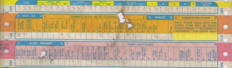

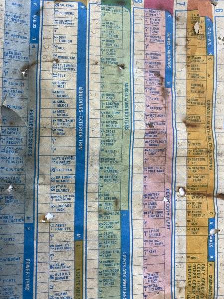

Hi I just bought a 1974 dodge charger I don’t have the fender tag I do have the build sheet I’m trying to decode and see if it’s a real rally charger ik those cars are very rare it says the trim sells code is u6 and it did have a v6r strip car the car was a black car with factory black buckets from what I can tell by reading the build sheet this is my first time deciding a build sheet any help would be really appreciated
A57 will be on the build sheet. Section A is called combination Groups.
Should also have and be coded for a "sport hood".

A57 will be on fender tag and build sheet to designate a Rallye. Also V21 will be the Performance hood(bulge hood)

A57 will be coded on the broadcast sheet.
St. Louis cars will code A57 and J54 on the tag. Lynch Road built cars will not.
Both will code V21.

Do you know What section on the build sheet it will be list on

LINE 7
