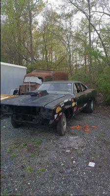

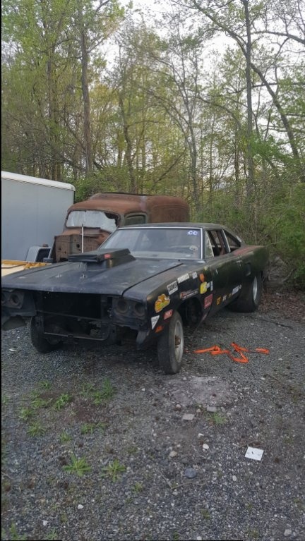

Put up some pics if you get a chance....we love pics here. :)
This is the only one I have right now
Nice....looks like the windows might be your best chance. :thumbsup:
