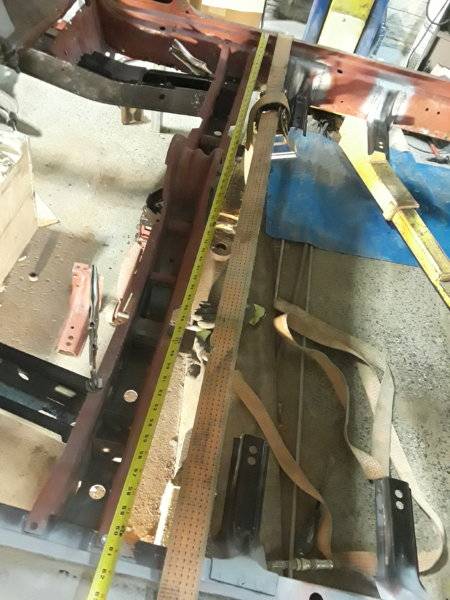

Hi guys need help Just need top floor measurements .

I have 70 dodge charger 500 replacing complete trosin bar,front and rear frames and floor.i have the measurement from the bottom but like to check from the top lip to lip

Thanks yes like to check few Times before I wield.

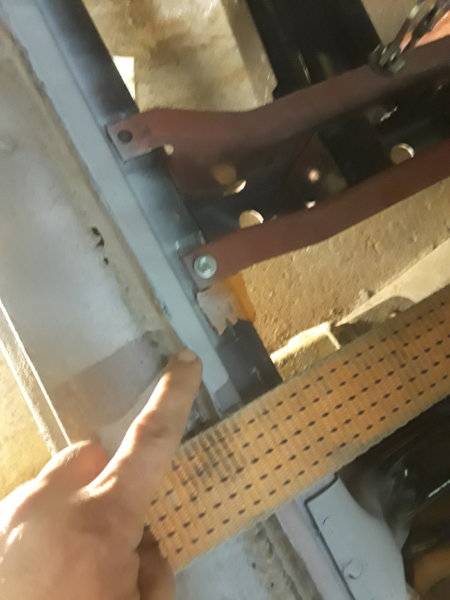

I want both side lip to lip of rocker panel.from the top and from the bottom. When I removed the floor pan i.didnt put support to hold it so.i think there is a gap between torsion bar.

Perfect I am getting 62 where is the torsion bar and at rear getting 62 1/4 so I have to pull the back one where the door handle side.
