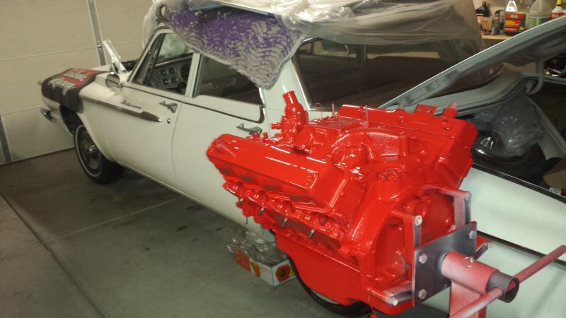

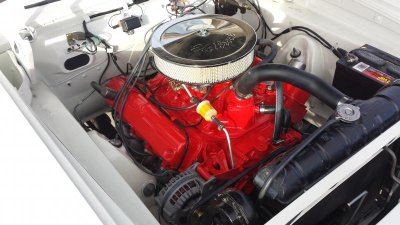

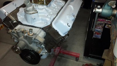

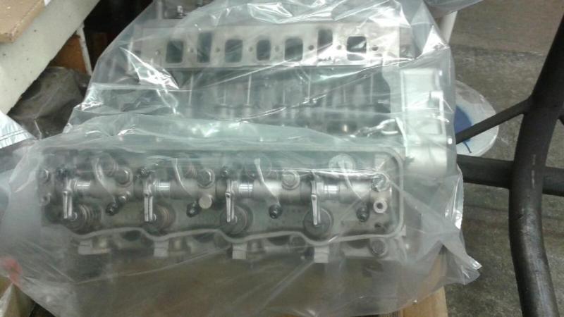

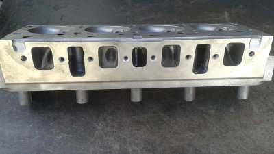

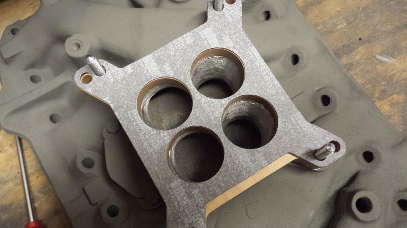

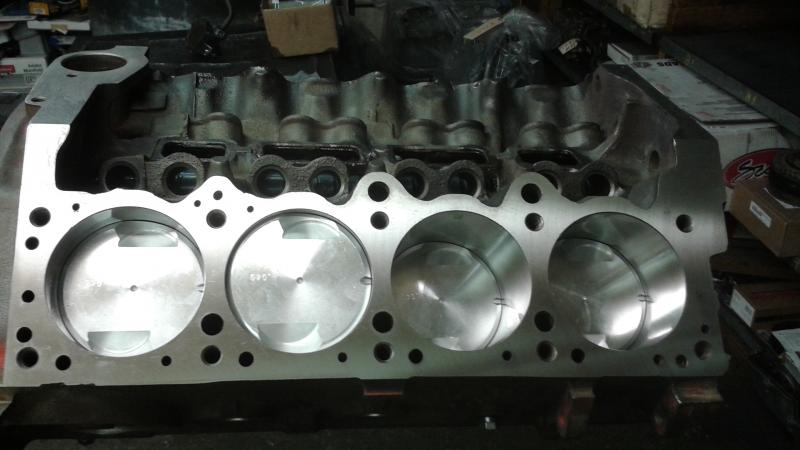

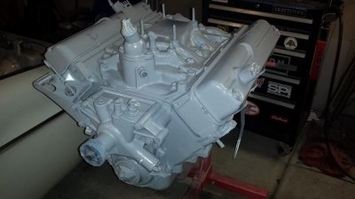

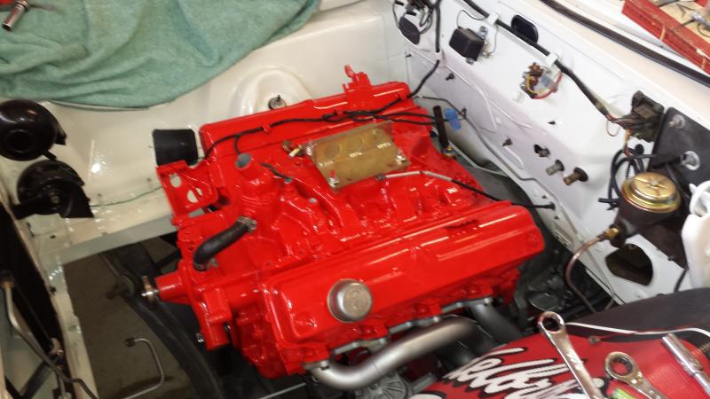

Stuck with the 318A and I am happy I did. Special thanks to GRC Performance and Gary Pavlovich for getting it done! It was already at .030" over and they took it to .040" over to clean up some scuffing. Some head work, new exhaust valves, springs, keepers and the rocker arm assembly rebuilt and spec'd to a true 1to5. Schneider .450 at 264* cam. Eagle I beam rods, polished crank with Egge 9.0 to 1 pistons, block decked and heads milled. Stock 4 bbl intake port matched to heads, crossover blocked off, plenum opended up for new Edelbrock 600cfm. TTI headers out through dual 2 1/2" exhaust and Dynomax Ultra Flow mufflers. Timing set at 17* initial / 33* total
10-10-15 completed short block (4)-1.jpg9-21-15 head and block after cleaning, blasting (10).jpg10-28-15 engine finished2.jpg20151102_063939.jpg20151103_211629.jpg20150406_214931.jpg20151104_185024.jpg20151107_161241.jpg20151115_160309.jpg

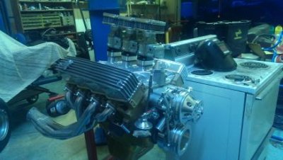

stay with the poly you can take that poly to a 396c.u. stroker on pump gas pushing 450+ h.p. that's what I want to do with my 65 satellite parts are out there I found a 3 duce manifold for mine but haven't gone stroker yet. I want to drive and show it when I'm done with it TX. weather I can do almost year round. no sitting in a garage or trailer queen.
My 396 CI Poly
