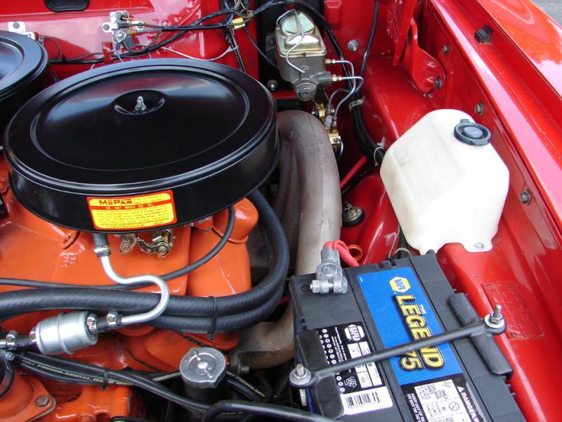

Hey folks, I'm mounting a '65 plastic windshield washer bottle in my '64 and would like to put it in as much of a 'factory' position as possible.
Could anyone that has a '65 with a factory plastic bottle take a measurement from the radiator crossbrace to where the most forward hole for the bottle is drilled in the inner fender?
I'd really appreciate it.
I have a 65 Coronet. It doesn't have a washer tank but if you can tell me where it mounted I will look for the holes and give you a measurement.
Thanks Rusty. The '65 tank mounts on rail of the left inner fender. Here's a pic (not my car) showing where it sits along the inner fender rail.
15 5/8" That is from the inside edge of the radiator support to the center of the front mounting hole.
