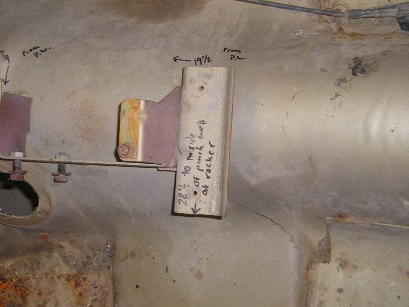

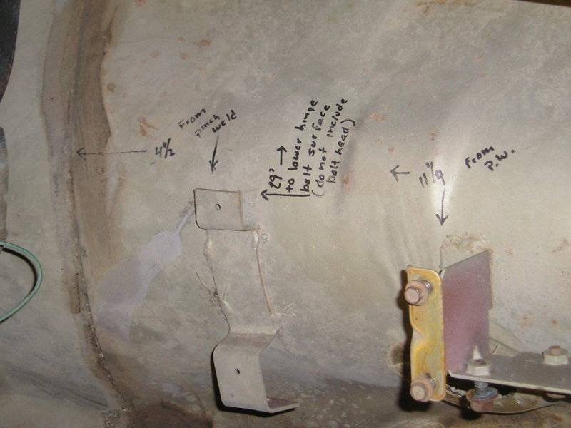

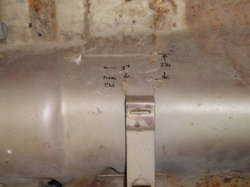

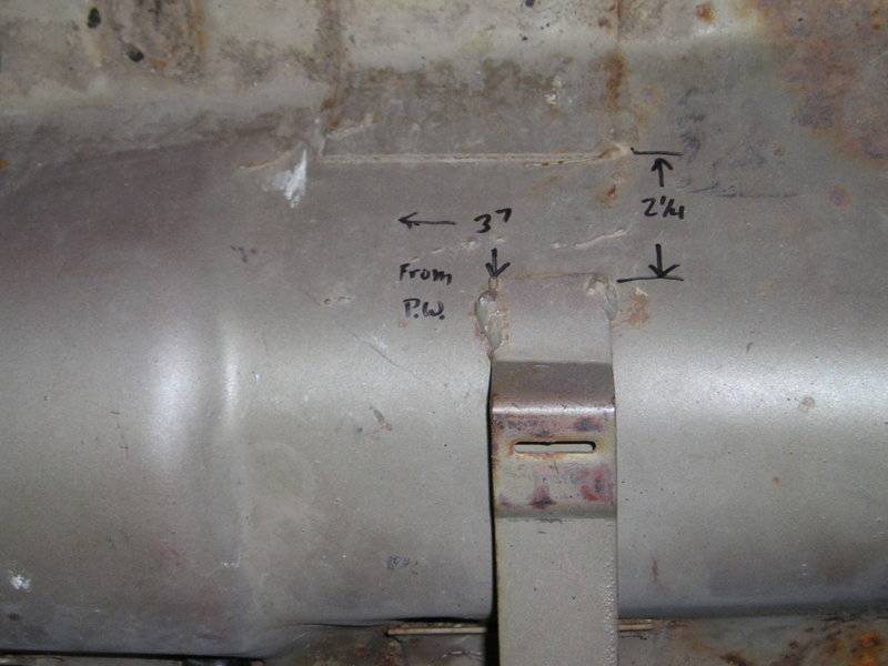

hope this is ok, but I need the measurement for the placement of the floor console and shifter brackets on a 68 Coronet R/T. from the front floor pan seam to the front of each bracket foot would be great. Thanks to anyone and everyone.
If this helps, I mounted all the brackets to the plastic console once and tack-welded them to the floor so everything fit right. ????
