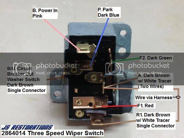

I have a 68 Superbee with rally gages, heater core was leaking so I thought since it was out I would instal the new harness... So I need photos on where the wires are going... most are simple but...
Washer button, three-speed wires
Radio with rear speaker controls
Images are worth a thousand words...
Help... Robert

go to mymopar.com and down load the wiring diagram.
