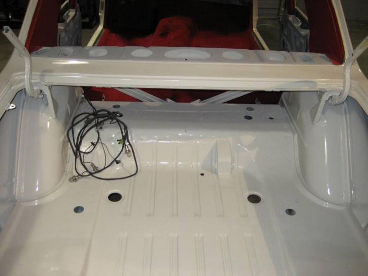

the trunk floor was replaced, great job, found the wire for the sending unit laying in the trunk, has two small clips look like they go on the back of the seat brace, has a factory gromet and end wire boot, but no hole in the trunk floor looking for factory placement thanks

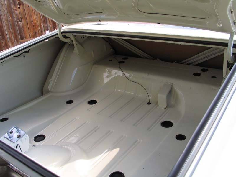

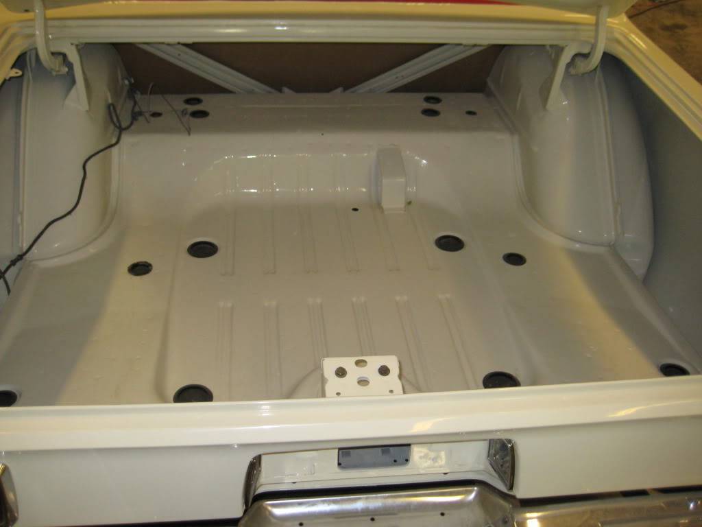

These should help. The hole is just to the left of the spare tire hold down bracket.
cool thanks could i get a pic of the driver side quarter panel just under the rear bumper need to see how it needs to look where they put in the new trunk floor and the backside of the quater panel meet...thanks.
