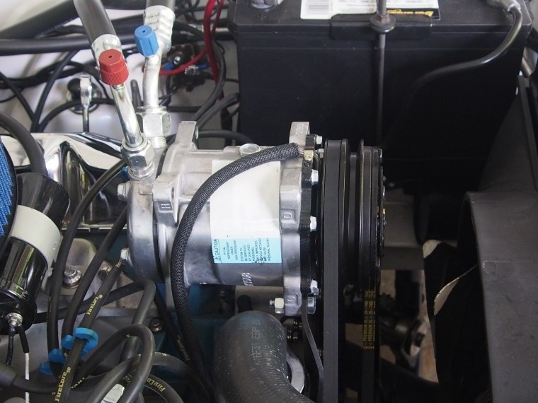

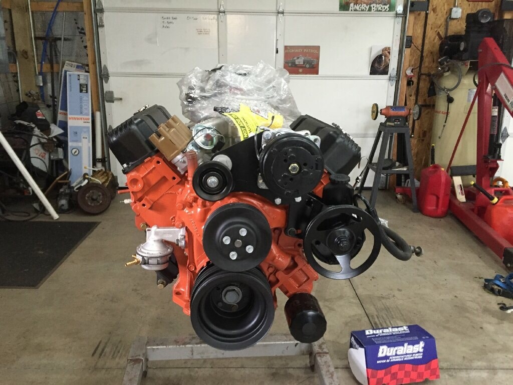

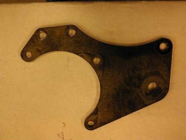

I bought a used Classic Air AC kit. I need some pictures of how the AC compressor brackets bolt up. Thanks I printed off their instructions but nothing there.

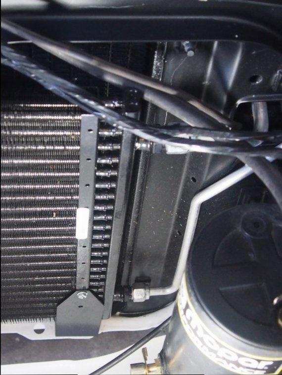

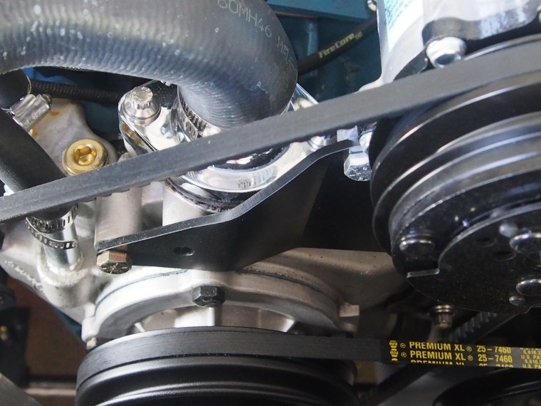

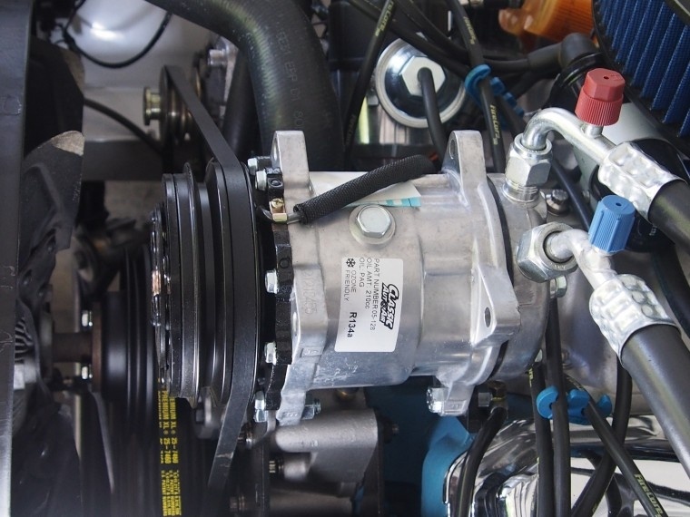

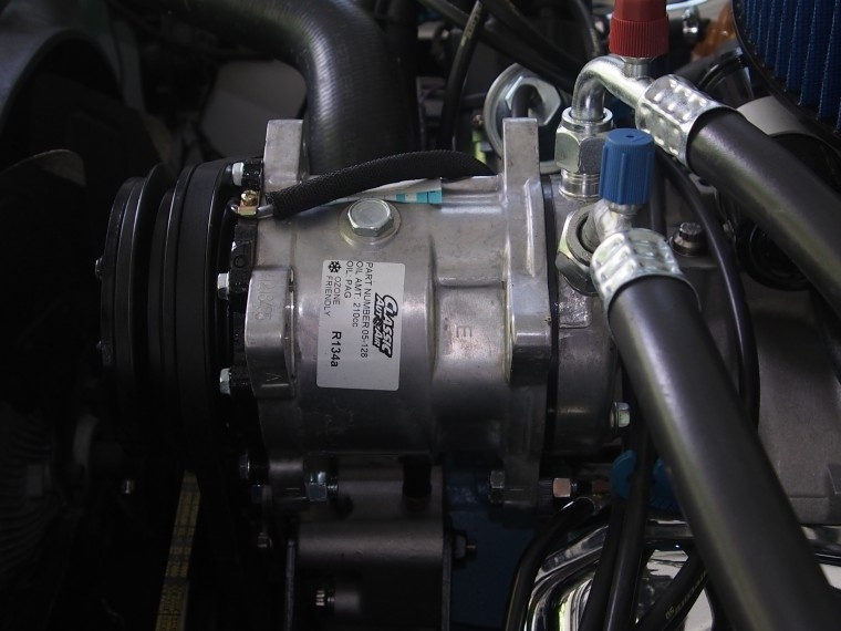

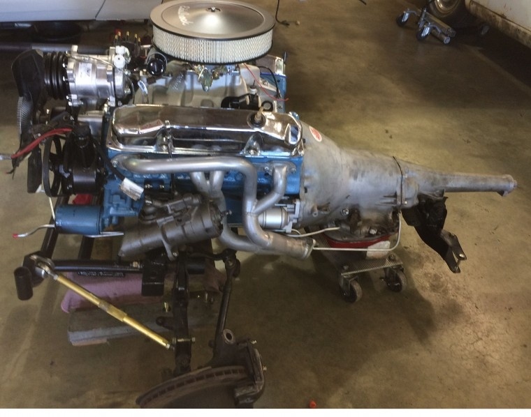

Here's my Classic Auto Air on the 400 in my '71.
phpzfa4HuAM.jpg 400 wAC installed.jpg AC Install.jpg phpBZVBe0AM.jpg AC Bracket.jpg
My bracket doesn't have a bend in it.
I don't think so but could be. Thanks. Your compressor looks a little different to. My kit might be older than yours.
I got a reply from Classic, very surprised and happy. He gave me all the info I needed. Reply was less than 30 mins. I have the correct parts! I'm all set.
