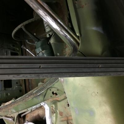

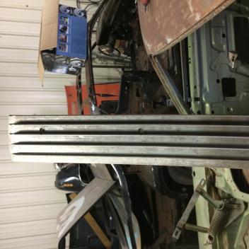

They were screwed on. I will get you some pics of mine.
There are ten screw locations on the panels and no clips underneath - they screw directly into the rocker panel.

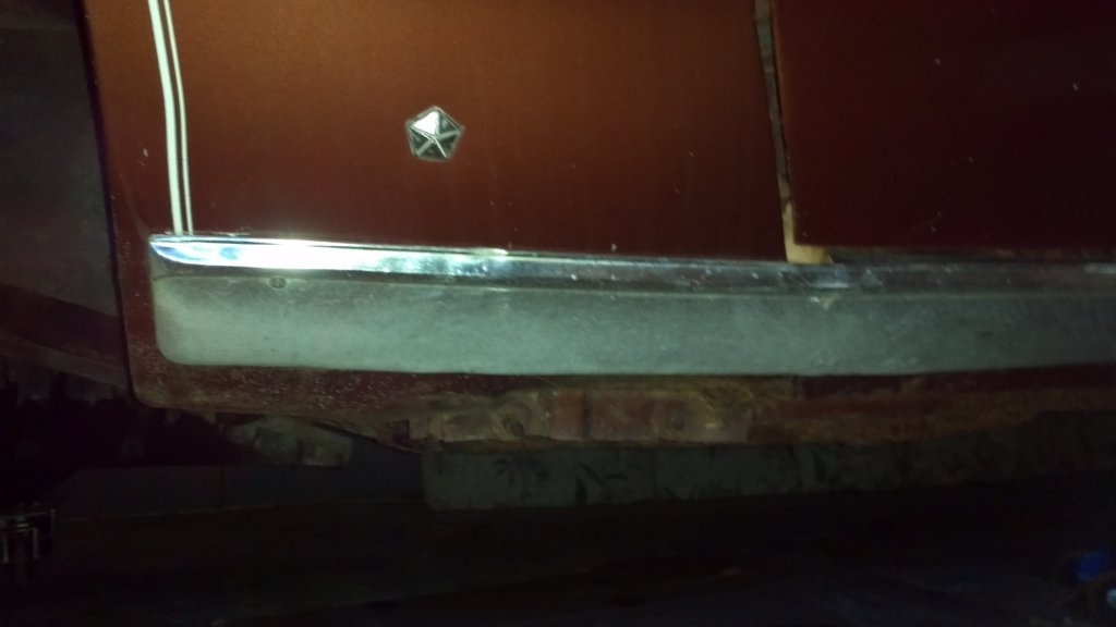

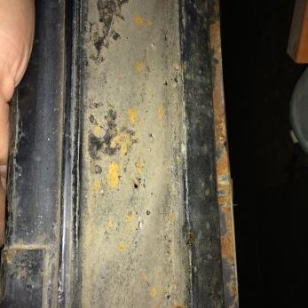

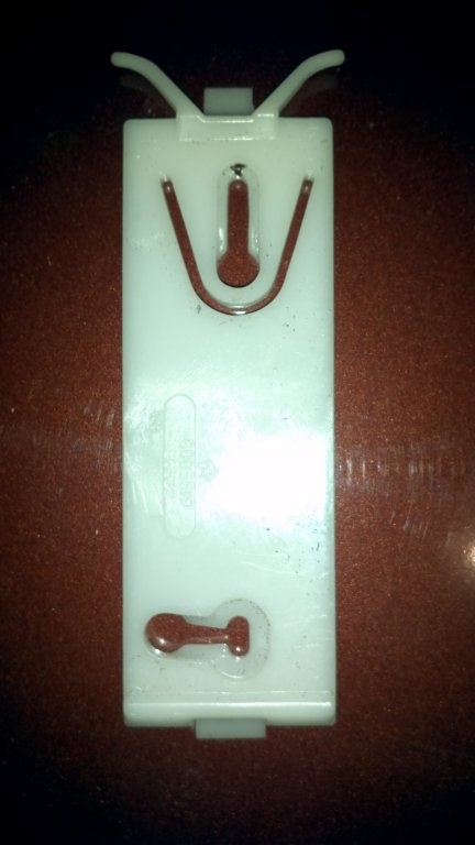

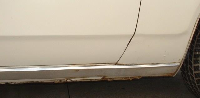

these are not mine I found them on this site some time back but they are the same and mine are screwed on like this also clips behind or were until some one misplaced or sold them on me

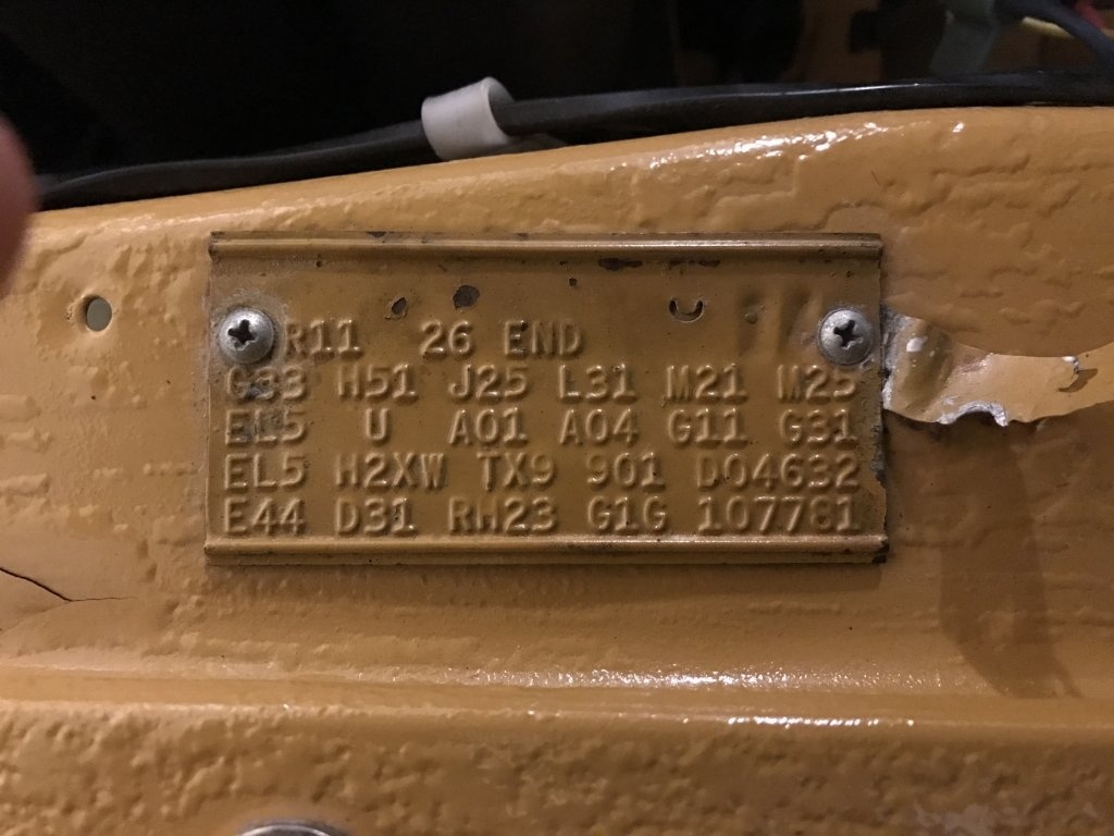

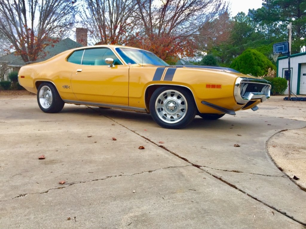

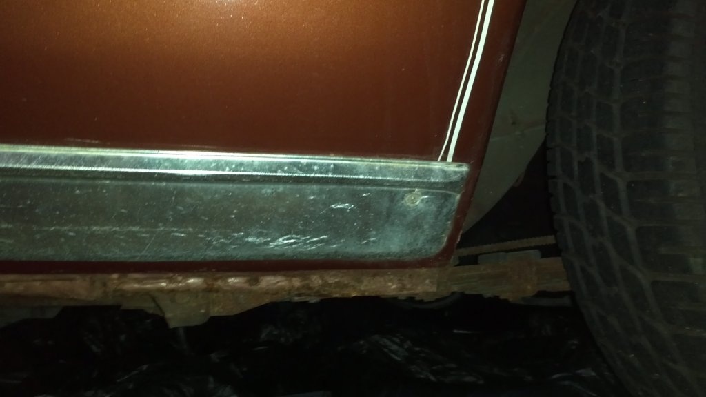

I was under the impression that the M25 cast aluminum rocker mouldings were GTX specific, but my satellite appears to have been equipped with them from the factory (if I'm reading fender tag correctly).

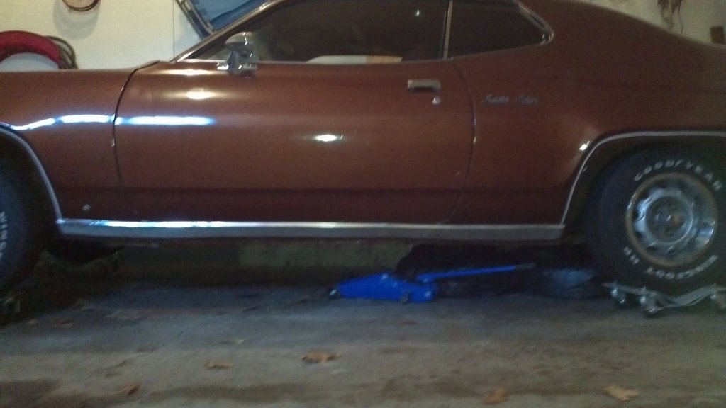

My '71 SSP has flat polished style with two screws front, one screw back. Not sure how many clips.
