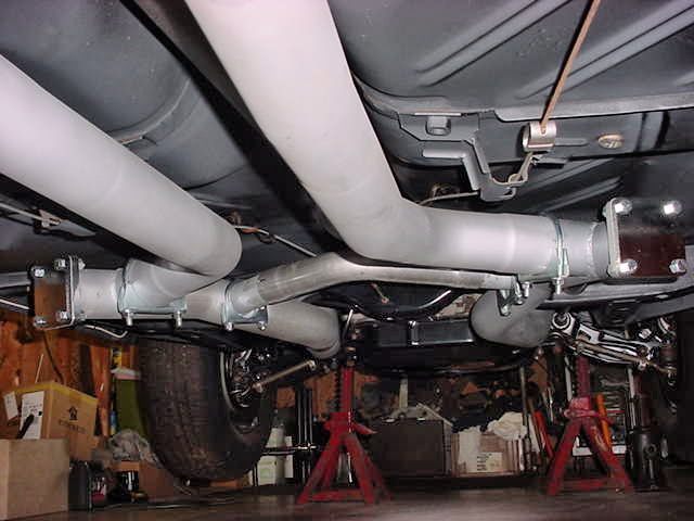

I'm doing a 64 Savoy post project and the floors were all but gone so i'm putting in new pans but they dont come with the e brake cable brackets on the bottom side. Can or does any one have any pics of the underside of one of these cars that would indicate the location of the necessary brackets? Any help would be appriciated. Maybe a tape measure held up to em to indicate the location. Thanks in advance. I can fabricate the brackets so all i need is the location of said brackets.

Here's one side,I'll try and get the other one.
Hey Max, That helps a bunch. The bracket the cable runs through was set with the floor pans and now i have a feel where it goes but i see another bracket that sets just behind the cable bracket with a big nut on it. What is it?
Small Block
Hey Max, looking at the e brake cable bracket there is a plate with a big nut welded to it just at the seam where it comes off the tranny hump. What is that piece? Seat belt bolt nut? Thanks
Small Block
I believe that's where the inner seat belt attaches.
