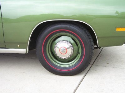

The 225/70's are going to be a bit taller but would fit the lines of the car great.
my 69 r/t with 225-70x15 on a 15x6 wheel.

Perfect. That was exactly what I was looking for. I will go with the 225/70/15 on the 15x8 Magnums.
