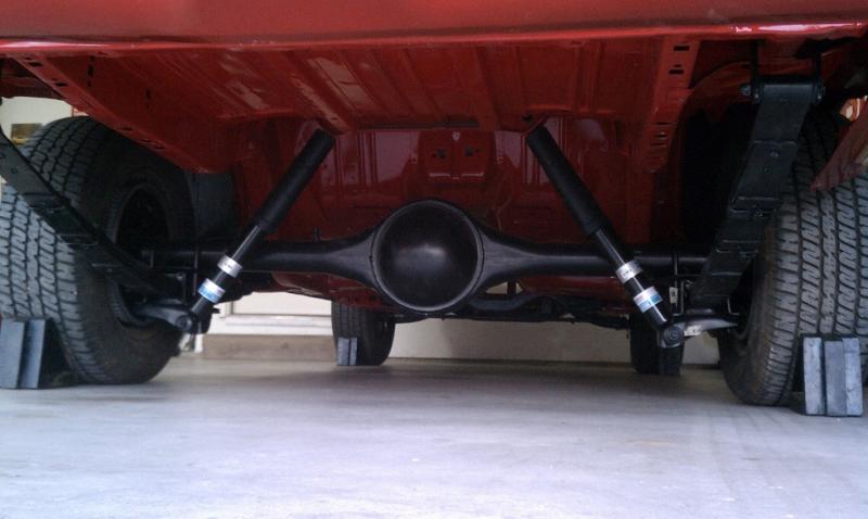

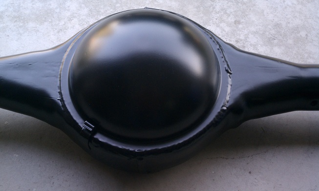

Here are some pictures of my Duster

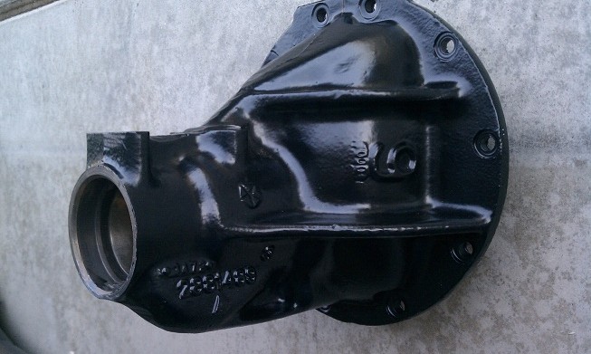

What I did for the gear case on my Duster is sprayed a base coat of cast iron and followed it up with a light mist coat of cast aluminum. Try not to mix brands to keep the possibility of a reaction down.

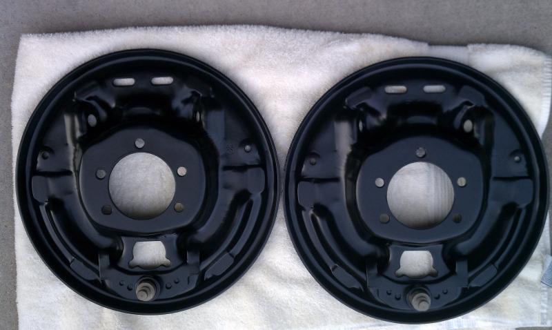

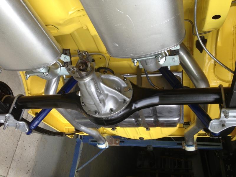

Here is my 73, all was powder coated 20% black, only thing painted were the leaf springs and it was painted 20% black.

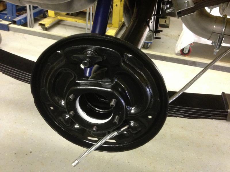

I'm currently doing the rear on my car also(74 Charger). I found the housing to be a gloss black (looks like the gloss you get from cheap spray paint), leafs natural, center natural, brake backing plates a little less glossy than the housing, isolator u clamps, gloss black, u bolts gray phosphate, sway bar brackets gloss black, front spring bracket natural, rear shackles, usually natural or a gray phosphate. My shock plates were a gloss black. St. louis built car. If you paint use a self etching primer and bake if you can. Sorry no pics, still in progress.

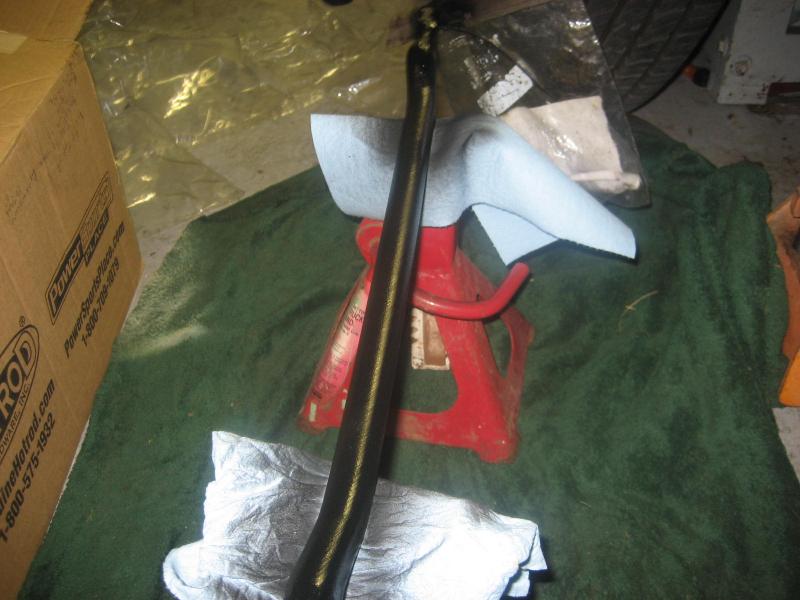

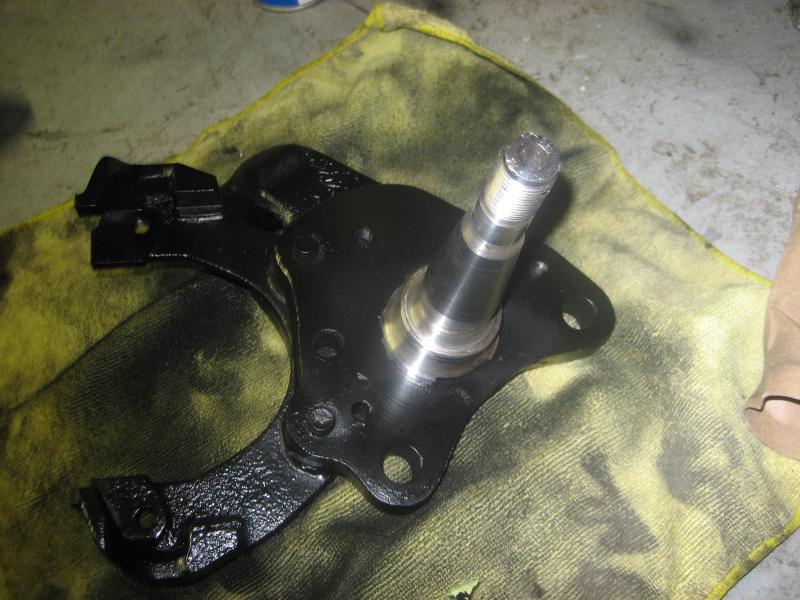

006.jpg017.jpg013.jpg016.jpg004.jpg006.jpgAfter cleaning up these parts I used the black wheel paint. Same stuff I painted my rims with.
