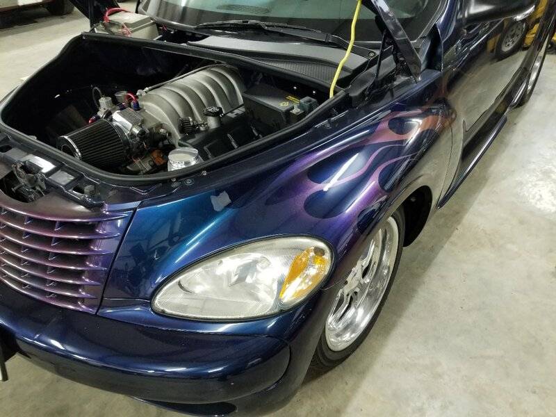

Battleship a couple years ago. PT Cruiser, Superbird.
